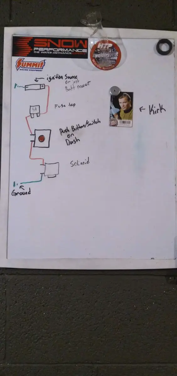

For future reference for anyone who finds this thread from a search, I'll post the wiring diagram on the instructions

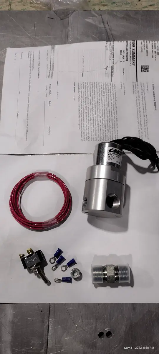

You asked fuse rating, I'd get a 10A fuse and switch.
The solenoid draws like 2 amps
My kit came with a 5 amp fuse
