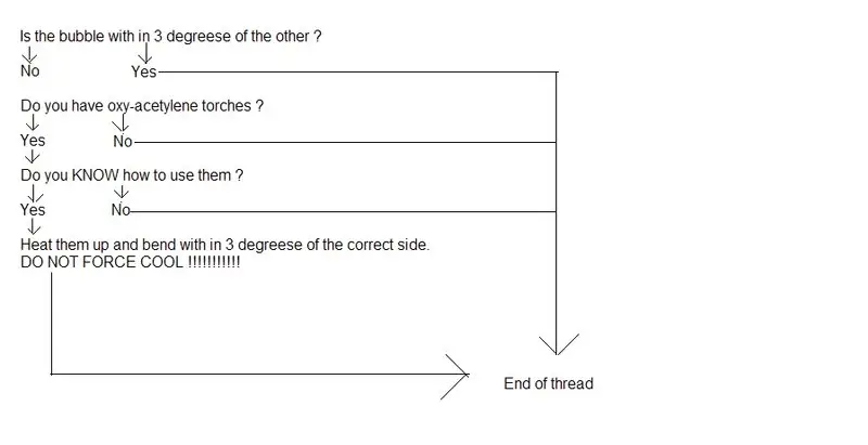

Take the bumper off.
Measure from the floor to the centrer of the bolt hole. Compare to the bolt hole on the other side. With in 1/4 inch ? Fine.
Get a small level.
Put it on the face of the bumper bracket.
Is the bubble with in 3 degreese of the other ?
No ?
Do you have oxy-acetylene torches ?
Yes ?
Do you KNOW how to use them ?
No ?
End of thread.
Yes ?
Heat them up and bend with in 3 degreese of the correct side.
DO NOT FORCE COOL !!!!!!!!!!!
