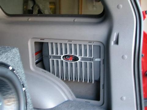

mines mounted in there. here a pic
Looks good. I need to try and mount mine forward of that because I am putting a Clarion subwoofer enclosire there with a Rocford Fosgate 8" Punch sub.

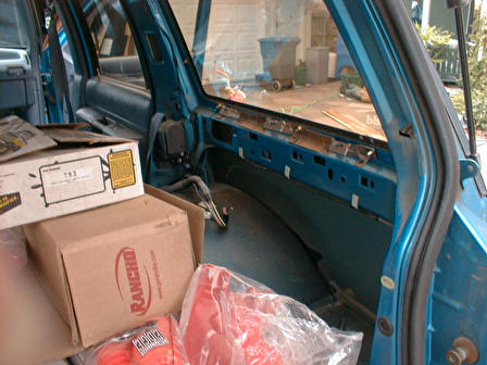

This shows the amount of space. If you mounted the amps back to back, you could get at least two where the stock one was.
How in the world would you get TWO amps in that space? One maybe, but two? Unless you get the really really small ones that are like 25W, I don't think you're gonna make it!
If you look where those wires are, that is where the stock amp goes, and it sticks out towards the center of the truck like the seat belt retractor in the background. Most of the wheel well is covered up with the interior panel, leaving room on both sides of that channel that the window rests on.
I only have one to mount right now, and it is going to go where the stock one goes, basically hanging on the inside of that channel.
