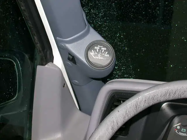

Here is the 15309.
It's been repainted and matches the dash better.
