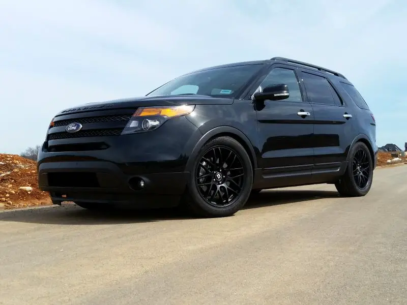

Well I don't have a lot on them yet, just drove around Frisco (Dallas) area a bit then back home to Paris (100+ miles) but so far:
The slight increase in width and height make it look much better on the rim. The original sport tires were too narrow for the 8.5" rim and resulted in a silly look. Based on the NT421Q product page, the 265-55-20 is ideal for an 8.5" rim and it shows.
The oversteer under hard acceleration is greatly reduced. I attribute this to the more square profile of the tire.
Road noise, especially on blacktop, is much improved. Initially there was a whine over 55 or so, but it went away after about 50 highway miles.
Gas mileage doesn't appear to be impacted.
My speedo is now actually accurate. It used to read a little fast.
Cornering feels great so far.
Nothing to report on ice/snow/rain yet. Might have wintry mix soon, so we'll see!
In your first post with the pictures, you say that the tires are 265/50/20 but in this post you said 265/55/20. Which ones are they?
Sorry, I got the 265-50-20 but that's the same width as 265-55-20, just slightly smaller diameter.
