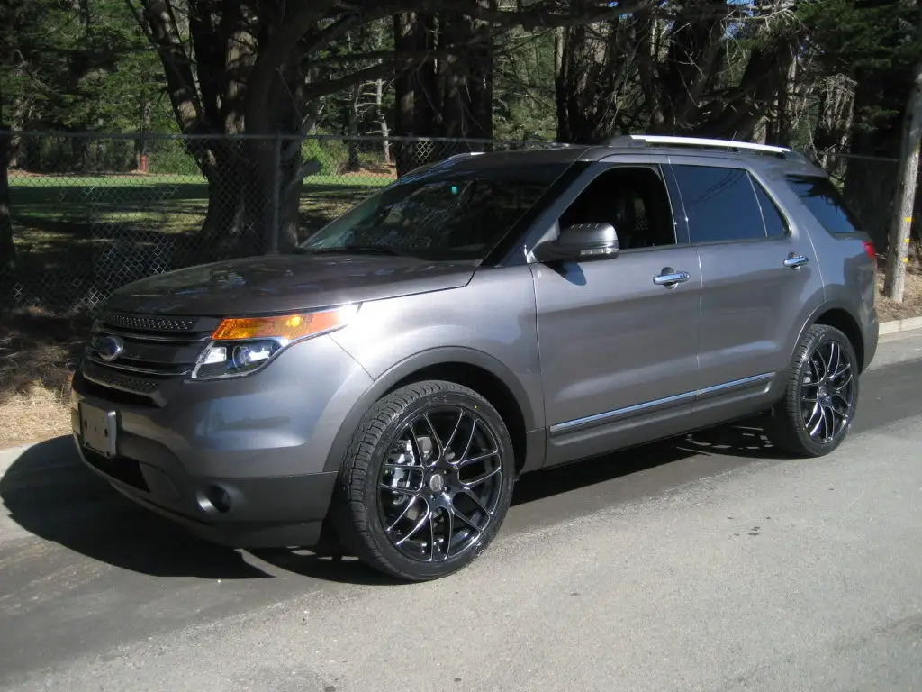

KMC District 10.5x22
I have a beautiful set of KMC District Wheels in black and with nearly new tires for sale in the for sale forum. Would love to move them for anyone looking to get a great deal.
Why? Curb rash? Any rubbing when turning?
One wheel has some superficial rash. I posted pics. I sold the truck. No rubbing. Road force perfect balance black locking lugs.

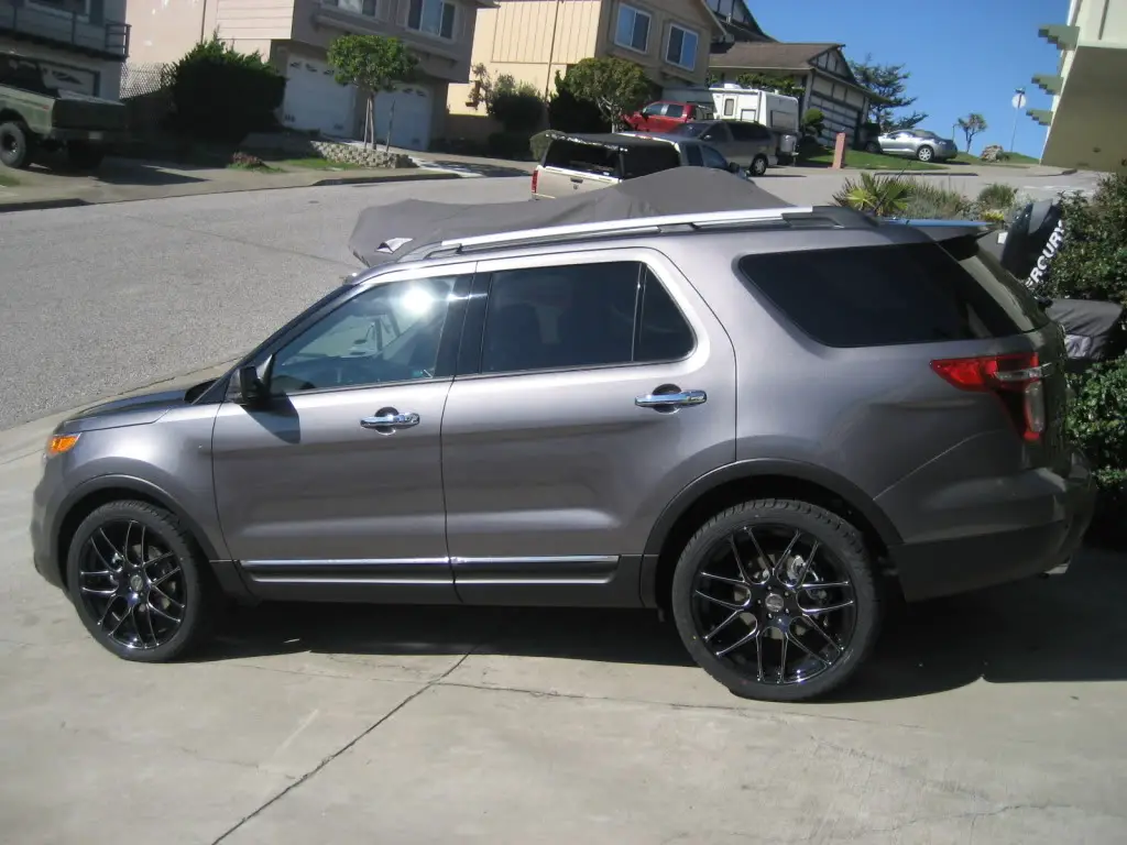

Falken RT-7M 22in wheels
I wasn't really into black wheels but I grew to like these. They look much better in person

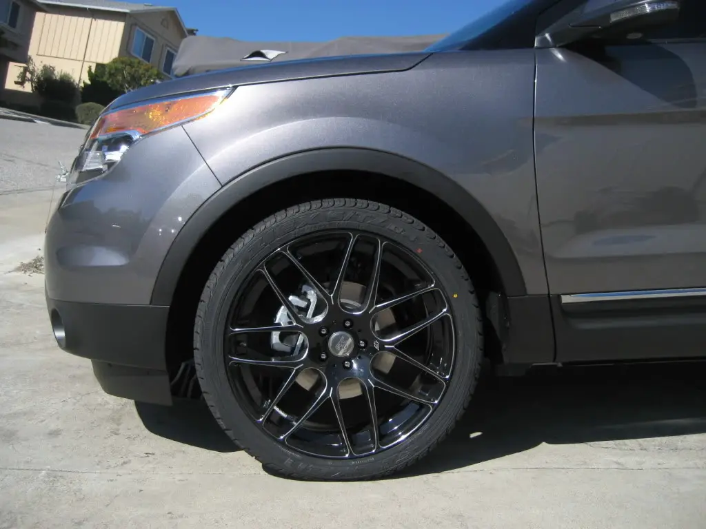

My new 22's :D
Koko Kuture Massa 5 (22x9)
Nitto NT 420S 265/40R22 tires
VERY slick comper!! I like that combination a lot! Thanks for sharing.

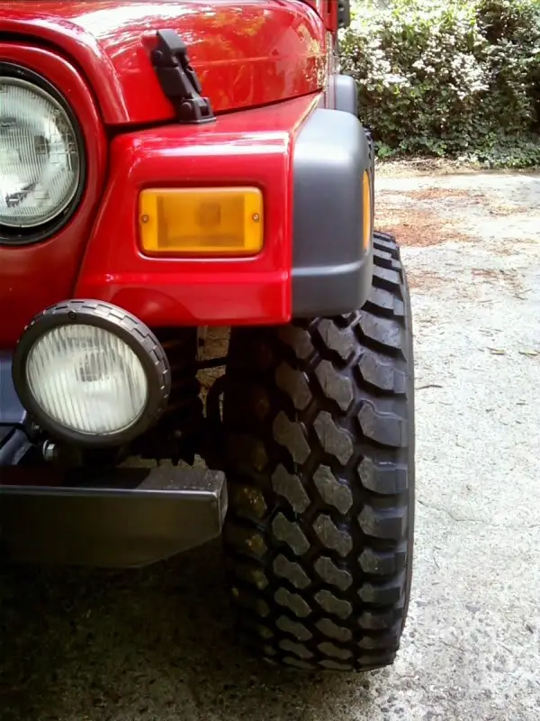

ETA: Well I take some of that back. I do love the stock Sport rims but I hate that nobody offers a mud terrain in 255/50R20 size, I mean nobody offers one. I might have to go to 18's to put on a pair of BFG MT's but that is a year or so away. Hopefully a manufacturer will make a quality MT in the stock Sport size. AWD/4WD is fantastic; but without a good mud terrain tire it's only half of what it is capable of in my experience. I went places in 4Lo with this beast that 90% of guy/girls wouldn't with the Dunlop MT's. I certainly couldn't go there with All Terrains and certainly not in an All Weather/Season Tire...
Originally Posted by Pratorb View Post
"That size difference is so small that you will ABSOLUTELY NEVER notice a difference in stopping. Of course there will be a difference but nothing that will even come close to brake failure. If it was that sensitive then people who lift and put significantly larger tires on their jeeps would be having brake failure all the time."
Pratorb, I quoted you for TRUTH! I went from stock 30" Wrangler GSA's to Dunlop 35" Mud Terrains 3-4 months after I got the Jeep. I drove my Jeep every day from 05' to April of 15'; until I was rear-ended from a stand still at over 40mph by an idiot looking at an accident and pretty blue lights instead of my tail lights... I never upgraded any brake components because I didn't need to. I could still lock up my Wrangler tires with the 35's as I used the Aluminum Alloy "Canyon Rims" that were OEM. I only put new (Wagner Thermo Quiet) brake pads and OEM rotors on her after 60K miles when it was time for a brake job. Were talking about a single piston caliber brake system here.
The Explorer's brake system is more than capable of running larger wheel tire combo without any noticeable difference in stopping distance. I wouldn't go more than 1-2 inches larger in overall tire diameter over stock without upgrading the stock pads to something like EBC "Yellow Stuff" pads first. But that is a super easy upgrade and the Exp brake system will certainly handle it.
Gone but not forgotten Jeep Wrangler on 35" Dunlop Mud Terrains, 3inch suspension lift, A-Z Fabrication front and rear armored bumpers and side rock sliders, and many, many more mods I did myself in my driveway/garage...
