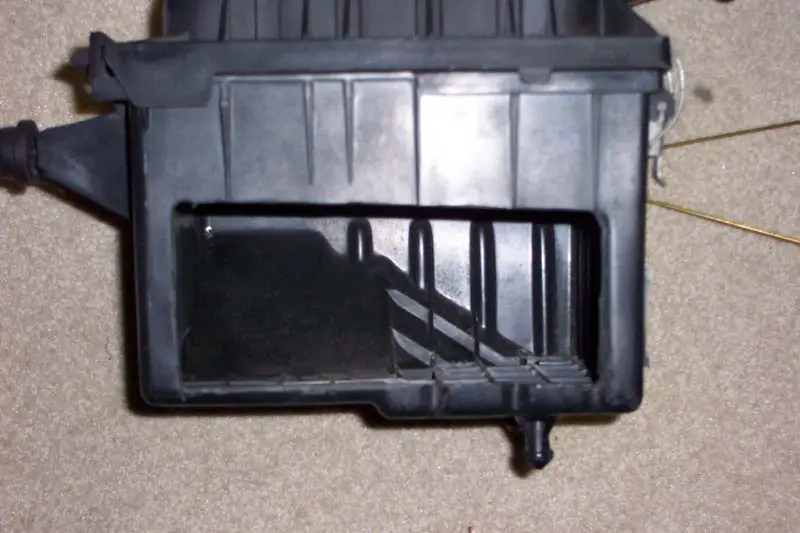

here is my air box ( Prior to my MAC intake )
doesnt look quite swiss cheesed to me. did u jst take a jigsaw to it or somthing? is it better with one big opening? or many small openings? and problems with water getting in there?
1) I used a cut off wheel
2) Yes, volume is the key,
3) No water problems, but I NEVER go wheelin'
I opened the bottom of the airbox in my Olds Alero just like MonMix's and it made a difference, though mostly in sound. All you are really doing is making more air available to the filter, but the stock filter and filter-throttle body tubing is still restrictive. To get the real effect, replace everything to the throttle body.
