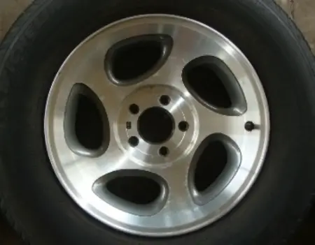

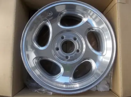

Stripping the clear coat off my OEM Teardrop rims using Klean Strip Peeler aerosol and looking for opinions. Should I remove the gray
paint in the holes or leave them painted? Once I start removing paint it will be too late and be much added work to repaint. Plan is to leave them bare aluminum and polish as needed. Every stock ST wheel I've seen has issues with the clear coat oxidizing and turning
white below the coating. First pic is stock with clear coat, second is an Ebay pic with the clear and hole paint removed. TIA
Leave the gray, it really makes the wheel. Too much of a good thing is still to much of a good thing, (so to speak).
Leave the gray.

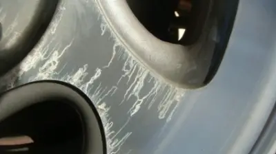

I wish mine looked anything like the stock with clear coat... mine is ugly and corroded. Anyone know of a way to rectify this?

I'm running both styles. My XLT has the holes painted silver from the factory. My Sport has the all aluminum polished. The painted ones on the XLT are much easier to keep clean. I polish the Sport wheels more than the rest of the truck. Everything seems to stick to them and stain. I'd stick with the gray they look good like that.
Thanks guys, looks like I've got a lot of masking to do. LOL Anyone else?

Aluminum wheels do not always take kindly to blasting. You will definitely loose the machined look if you do. However, if you just want to get the wheels coated a single stage color, it would probably be in the neighborhood of 60.00 per wheel in black at a coating shop. For this price you'd drop them off as is and pick them up when finished.
Now you can see why at this point most people elect to just get a new set of wheels. Especially when you consider the stockers will be worth about 50.00 as scrap aluminum.
You do not want any part of a polished aluminum wheel with no coating for a daily driver. Trust me on this.

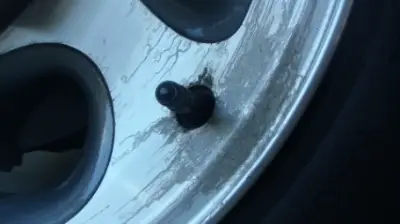

It really comes down to doing this as a temporary, albeit labor intensive fix. What's frustrating is the oxidation started very small on each wheel and progressed to this within ONE year. Despite Hawaii roads not having salt or corrosion issues, it always appears to start at the edges. Maybe I'll take your advice and use these unsightly rims until I'm ready to replace them. Thanks.

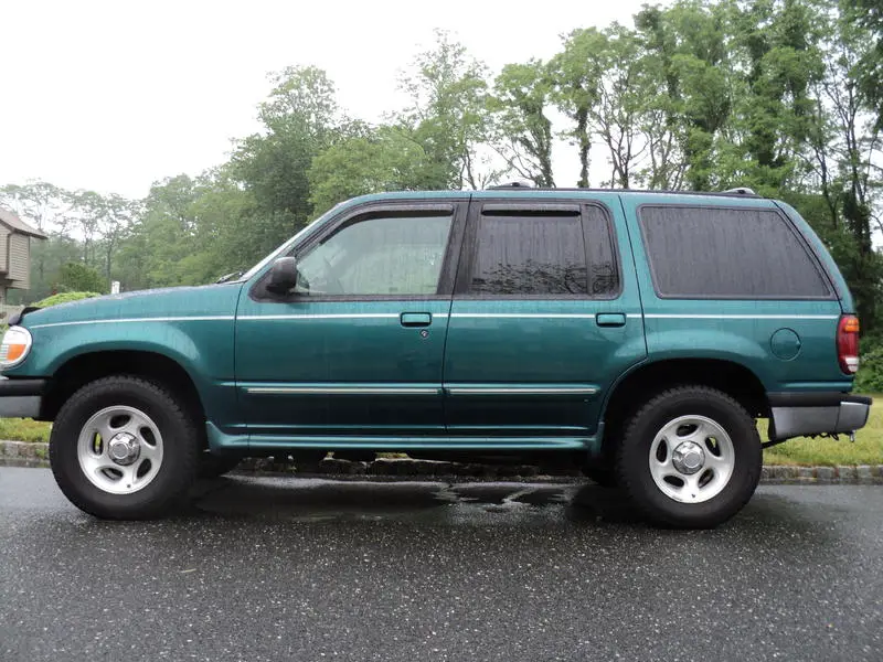

My XLT with silver.
My Sport polished.
