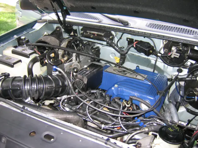

Ah yes I should know better.
So I am on my way home from work on the higway and I smell coolant...
I look in my rear view and the Subaru behind me has his wipers on, I figure oh great its me...
I pull off next exit, temp is climbing slowly....shut her down and STEAM everyhwere.
Pop the hood figuring the worst has happened (intake gasket, water pump, etc) But no the small hose from waterpump to thermostat housing is split!
I pour in the drinking water I have and make to a 7-11, 1/4 mile or so.
7-11 sells 3m clear duct tape thank goodness.
Wrapped the hose with about 14 pieces, pour in 2.5 gallons of water and drive her home 2 miles...no heat issues.
Still leaking, but only a bit.
Life lesson: So if I had zip ties and duct tape in the glove box like I should I could have made this repair anywhere, at least enough to get me to the next exit.
Shiny and wet, but not from a recent clean....its coolant
Small leak now
Clear duct tape saves the day
Of course I have a spare hose on my spare 5.0L so it will be an easy repair, once she cools off...
