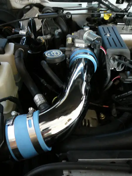

I got the v6 mac intake to fit onto the v8! I flipped the tube around, sealed off one of the holes with an old 60's vw door hinge plug and added longer bolts and rubber shock bushings to the mac mounts. The longer bolts gave me enough play to align the intake tube. :)
