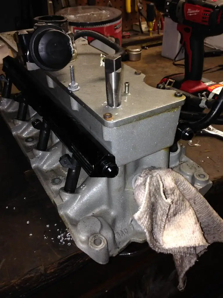

Well Tim, I took the leap of faith and drilled nice big hole in the top plate of the EE supercharger kit so that I could move my intake air temp sensor.
Fingers crossed it works out!
At least if something goes wrong that part wouldn't be too hard to make,
That was my thought exactly. Nice flat piece of aluminum with some holes in it.
Sensor
Looks like it was made to go there!

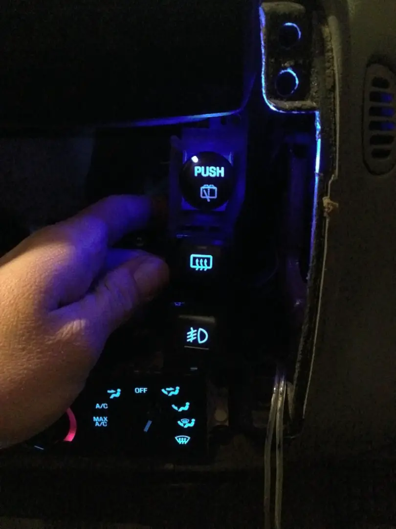

Dash LED conversion

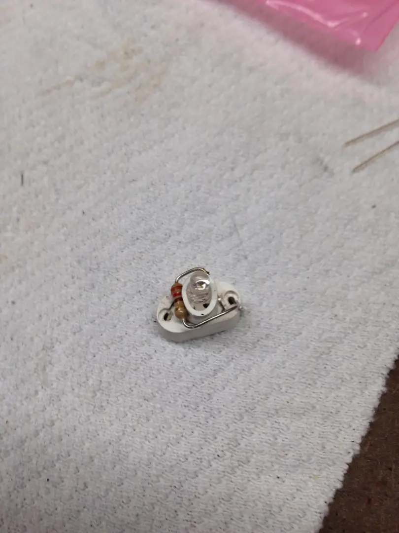

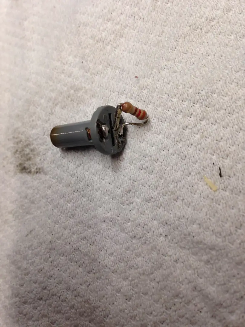

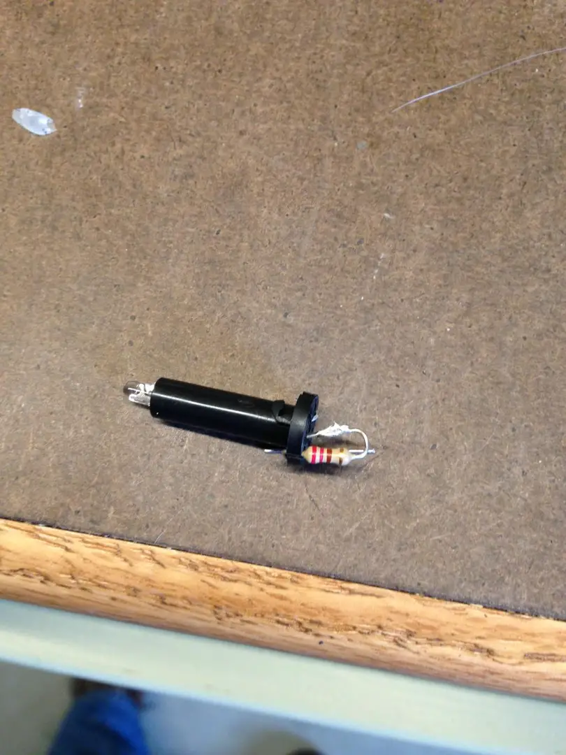

A while back I changed all of the 194 bulbs in my dash to white LEDs. On a 96 with the film color of the dash, that mixed with the bright white LEDs made it take on a blue look, which is what I was going for. It took me 3 years before I finally decided to change the rest of the green switches to blue LED. I purchased LEDs from superbrightled.com. All of the ones I had to solder in place are 3mm blue LEDs (RL3-B2030 Blue 3mm LED) with the correct resistors (CF1/4C221J 220 OHM) to go with them.
The first 2 lights from the left are the stock lights from the rear defroster and fog light switches. 3rd from the left is a premade - plug and play blue LED (NEO3-B 3mm NEO3-x Blue) for use in the rear defroster and fog light switches. Far right is the stock 4x4 control light.
4x4 selector switch light
Rear wiper control light

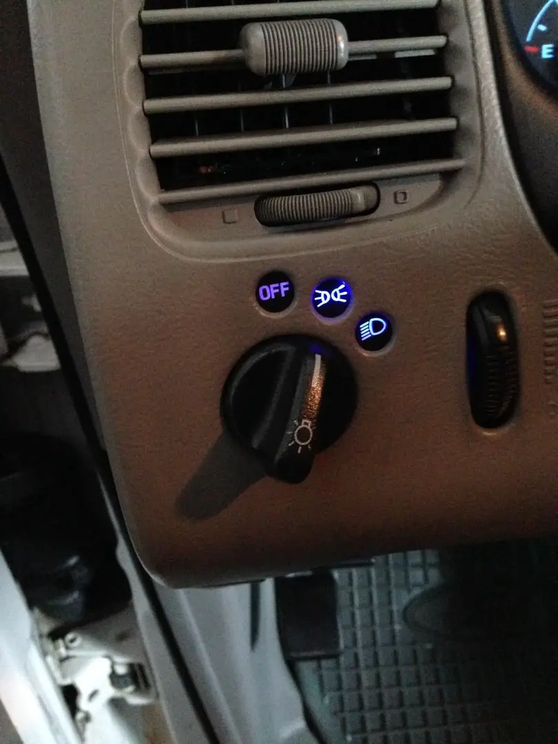

Head light switch light
nice. they look like they match pretty close to. looking at the pics i can tell if i did them for you and got them from the place i normally get them from (locally, and i still can think of the name of it) they would have been to dark of a blue.
so was the 4x4 as much of a ***** as i was saying?
I'm going to do the door switch now, right after I finish up under the hood. I went after that small antifreeze leak (thermostat housing) and I am going to wrap that up within the next couple days. Then I'll do the door switches.
I see why you said the 4x4 switch was hard to do but (probably because you told me it was a SOB) it wasn't that bad. It actually went pretty smooth!

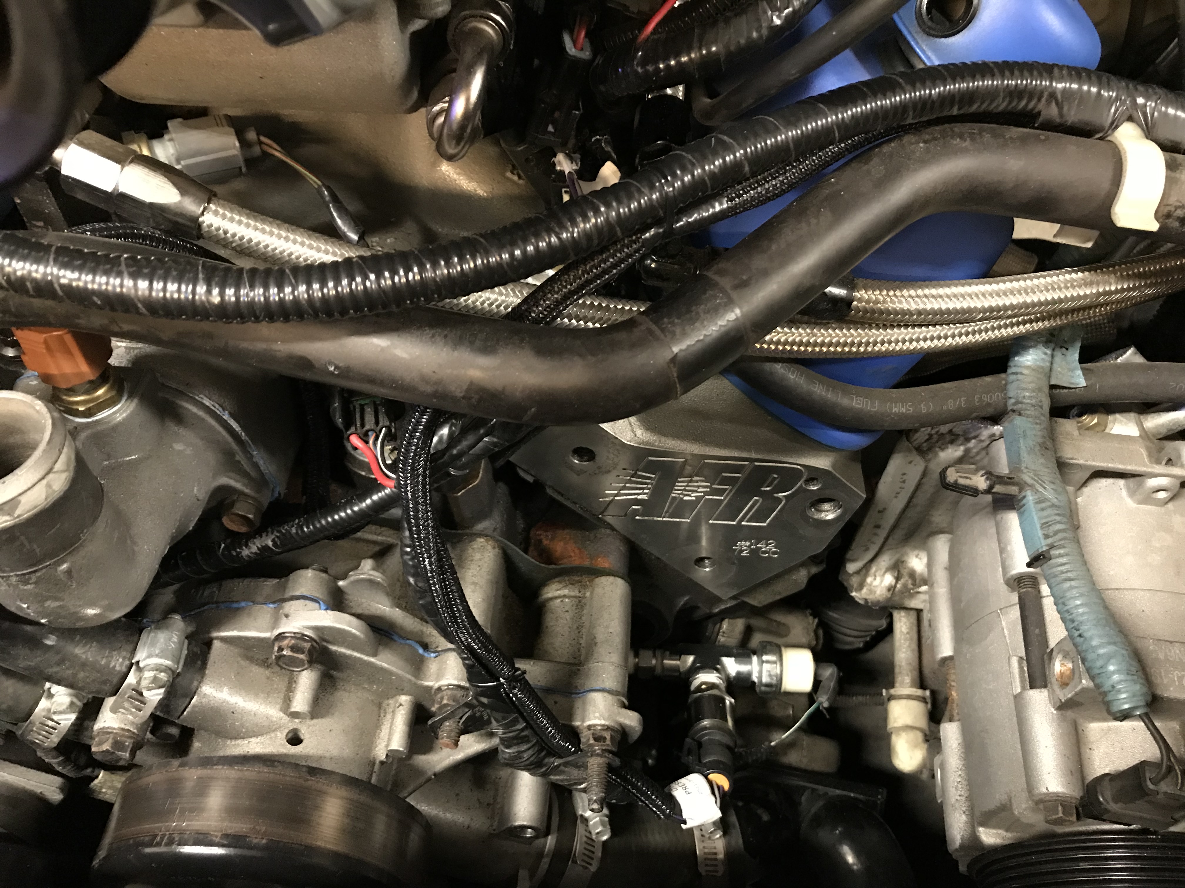

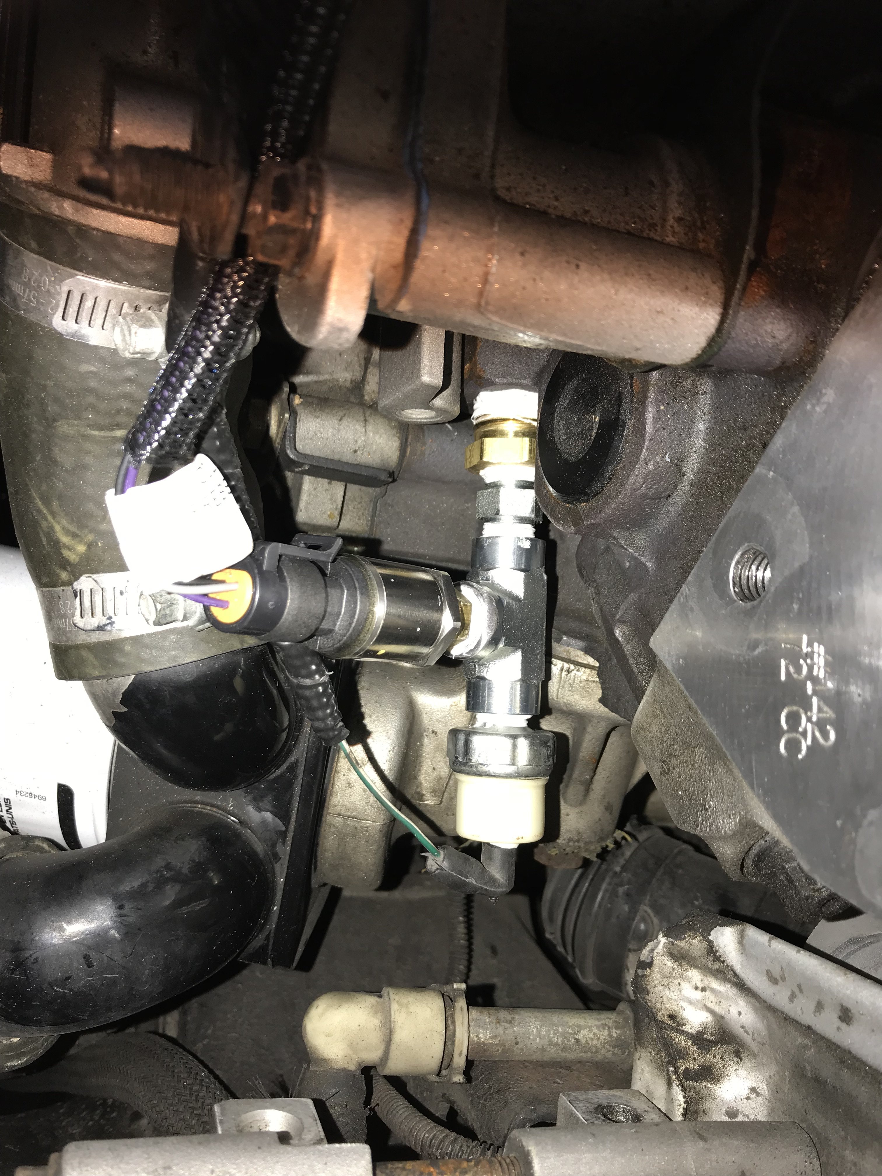

Anyhow, the last mod I did was adding a Ford Racing oil pressure sensor and a coolant temperature sensor. The first picture shows were i put the oil pressure sensor. I moved the stock temperature sensor to the thermostat housing by drilling and tapping the stock recessed spot in the housing. That allowed me to put the new coolant temp. sensor in the factory location directly in the intake for the most accurate reading.

One thing I have to mention,
I would move the stock coolant sensor back behind the thermostat where it was so it doesn't effect your tune.
The A/F and timing etc are based off the temps behind the thermostat.

I did some research on the coolant temp. sensors. There are 2 factory sensors in the intake. 1 is for the ECM for tuning purposes and the other is just for the gauge (1 sensor is a single wire while the other is a dual wire). I moved the one that just gives a signal to the factory dash gauge. You can actually see the aftermarket gauge increase in temperature before the thermostat opens allowing the factory gauge to start reading temperature. Does that make sense?

That does make sense about your sensors, I didn't realize there were 2 from the factory.
The one wire sensor was usually for the gauge, the two wire was usually for the PCM.
