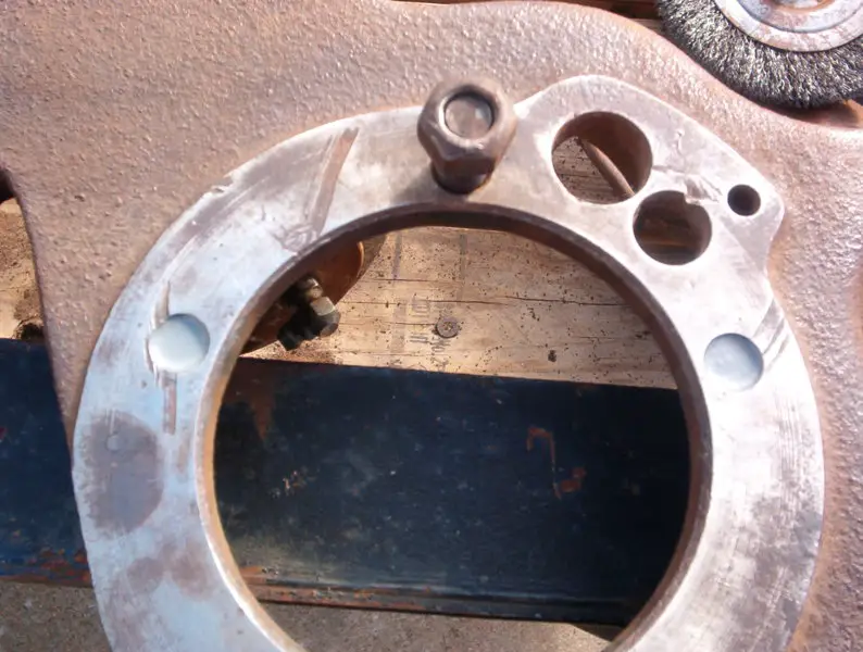

Pic's that were on my web site. 44 caliper mounting plate.

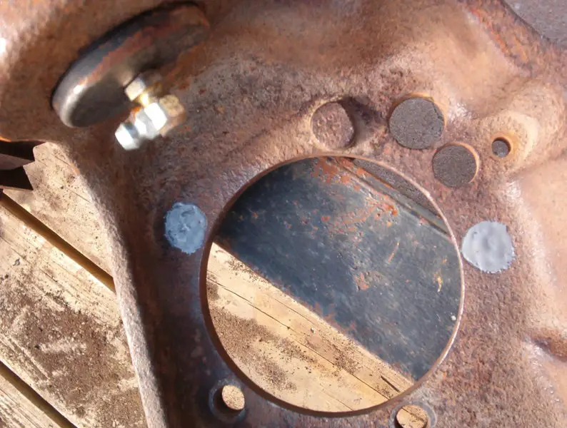

35 TTB studs I cut to plug 2 holes in each knuckle.
Holes plugged with cut studs and JB Weld.
