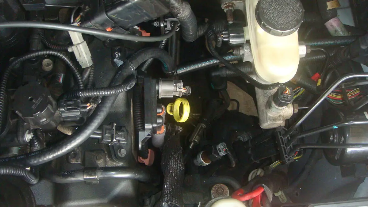

Touched the purge valve hose (4L5Z9G271BA) connected to the manifold and my hand turned solid black. It's also known as the Vapor Management Valve next to the power distribution box. Searched for an OEM replacement with no luck and used 3/8" Gates Barricade® Fuel Injection Hose (MPI) found at NAPA. O'Reilly, or other Gates dealers for around $6 per foot. I suspect the deterioration is caused by a combination of heat and blended ethanol fuel, but I'm surprised to find very few reports on this forum. After further inspection this is the only hose on the vehicle I found under the hood with issues. Need to drop the spare and inspect any rubber hoses connected to the the canister and fuel tank next. I've also read the 2001-03 Sport Trac purge valve hose is connected to a different location on the engine than the 2004-05.
