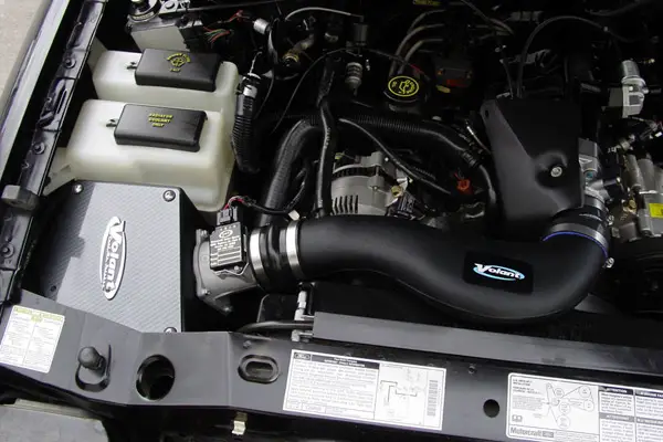

Looks so much better than stock. I know it wont add much but Im just really trying to clean up the bay as much as possible
Volant is probably the only TRUE cold air intake for your '98 4.0 OHV Sport.
The air box ports pull air from the factory headlight location and the fender well,
instead of an open cone filter in the hot engine bay. Nice also comes with a price.
You would have to be REALLY set on a clean looking engine bay considering your stock intake pipe already flows about 2-3 times as much air as your engine can use.
My junk yard CAI. made out of stuff laying around in the garage. probably not what you were thinking, but the point is you could make something that could look really good (and functional) pretty inexpensively.
