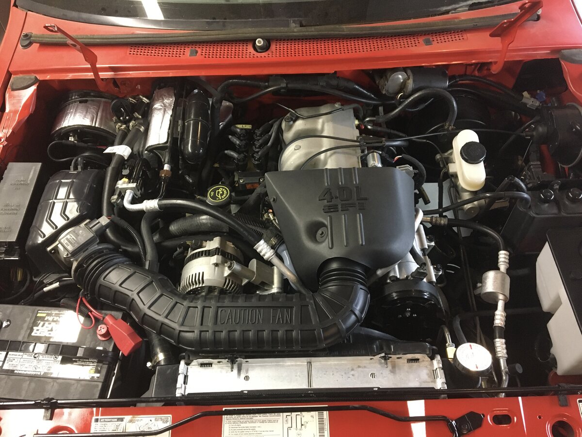

There is a ton of good experience to draw from on this website. I did the engine replacement for my 1993 over a period of weeks so I wasn’t as rushed. I’d definitely recommend you buy a good shop crane and engine stand, as well as a load distributer. A friend is also going to come in handy for the install. Be sure to check all of the wiring before reinstalling it. The engine is a tough ******* but on a vehicle this old the wiring is likely going to need some attention. Just be sure to stick to a plan and budget. I got carried away with my rebuild and ended up with this:
