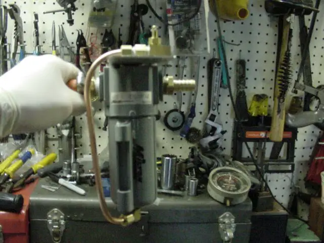

Next project for the week will be building a pressure lubricator, I drilled and tapped the A/C manifold on the inlet side and installed a barbed fitting for an oil hose. Currently I'm feeding oil back out of the separator under pressure into the compressor, although this worked well for today’s test I noticed that the oil going back to the compressor looked a little dirty and I suspect there might have been some water in it, there was also no way to stop the oil flow once the compressor shut off without closing a valve manually.
I'm envisioning a separate reservoir filled with clean oil and a valve on the bottom. I will pressurize this reservoir with air from the regulated side of the air tank through an electric valve that will open when the compressor kicks on forcing oil through the hose and into the compressor and off when the compressor kicks off stopping the flow. The valve on the bottom will give me a little bit of control over how much oil gets to the compressor, the trick will be adjusting this for optimum flow without burning up the compressor in the process. I’ll probably use a big air filter reservoir since I have a couple more and they are designed to work under pressure while being clear so I can see how much oil is left.

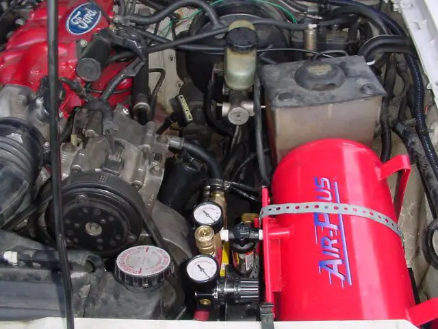

Today I ripped it all out and cleaned up the installation. I kept the cool steel tank mounting staps for the bling factor. :rolleyes:

Nice clean up man!! That looks nice. You're right the tank strap has got to stay. I haven't gotten started on mine yet. I've been battling with the misses on my new wheels and tires coming tomorrow. Hopefully soon I'll start mine. Keep the info and pics coming.

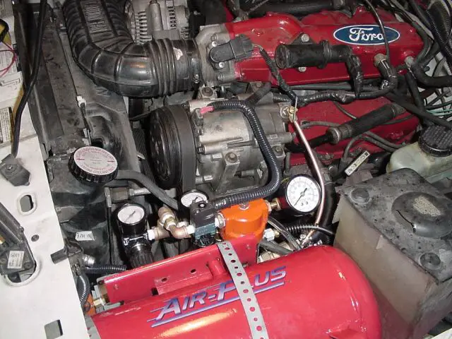

New Lubricator...

Ok so how well does it work. This looks almost proffesional! Ahhh yess though, there's the getto strap.

I dunno yet, I accidentally dumped the entire oil reservoir down the intake of the compressor while I was playing with the valves and solenoids so now there is way too much oil in there that I have to run out before I can see how well it works.

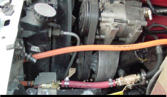

It's basically an on off switch controlled by pressure so it doesn't matter if it's AC or DC the function is the same. But to be really honest with you when I took apart the compressor I found that they were using a 120V DC motor with a rectifier bank to convert the AC to DC don't ask me why the 'F' they did that.
I c-tapped extension wires into the wiring for the original pressure switch and ran them around to the new pressure switch, once again the function is the same. I'm going to do away with that setup in the future when I built a control panel somewhere inside the cab just for OBA. It's kinda funky to push the A/C knob every time I want air plus if I try to use the defroster it kicks the A/C compressor on when I don't want it to.

Ok that was what I was thinking you did. But I didn't realize it didn't matter the AC or DC. And about how to turn it on... come on you hit the "air" button to get "air", man!! Ok I'll stop (one day). Thanks though this is going to be a breeze to do myself.
