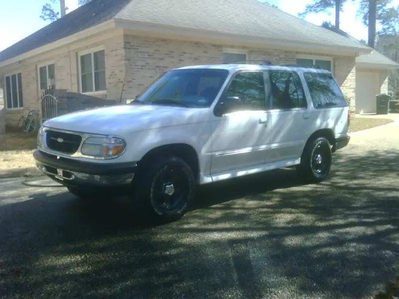

I painted the insert black, but not the chrome trim that goes around the headlights and stuff. I did it last year, and so far (knock on wood) it still looks great. I think I just used Dupli-Color Trim Paint. I don't have any good pictures on this computer, so this is about as good as it gets:
Maybe tomorrow I'll try and take a close-up, but all I have is a camera phone. :thumbdwn:
Edit: found one more, but not head-on.
Hey florida are those stock rims painted black if so how did you do them?
Why, yes they are. :D
I just sanded them a little, especially in areas where they were pealing, scuffed them with a scotchbrite pad, cleaned them, used a degreaser, taped off the tires, then blasted them with some primer. Then I just used black Rustoleum paint. I don't remember the exact kind of Rustoleum nor the exact primer, but anything should work. I wanna say they are semi-gloss black Rusoleum protective enamel (not even wheel paint, just normal Rustoleum), but I'm not sure. But like I said, I think anything will work, but I've had good experiences with Rustoleum.
The only complaints I have is that I was lazy and just painted over the wheel weight, and the wheel weight on one wheel is now peeling, but I'm planning on just getting a small brush and painting over it again. Plus when I get new tires, I'll probably have to paint them again where the wheel weight used to be. Other than that, they still look great; no peeling or cracking that I notice.
I'm very pleased.
Edit: I did them about a year ago, and they still look great, though they may have lost a little of their shiny-ness now. They still look good, and the picture above was taken last month, but they aren't as shiny as they originally were.
