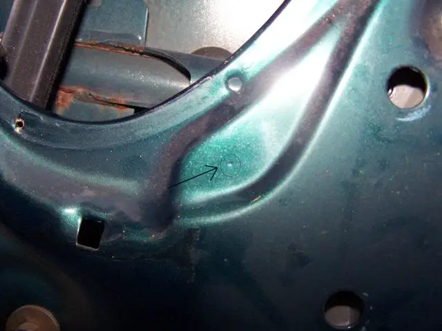

You need to drill a 1/2 inch hole RIGHT HERE
It will end up looking like this

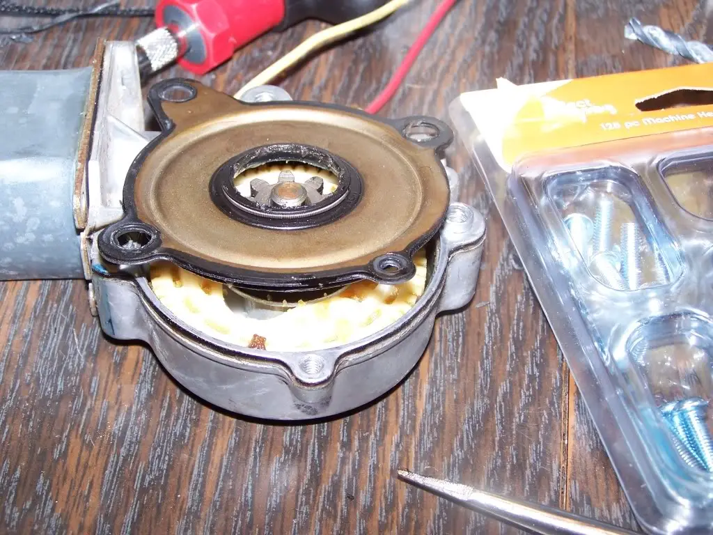

Pull the three motor bolts out and take it somewhere to work on it. My wife loves me, so I get the kitchen table :) Remove the TORX bolt (T20 i think)
Pop off the top w/ a screwdriver

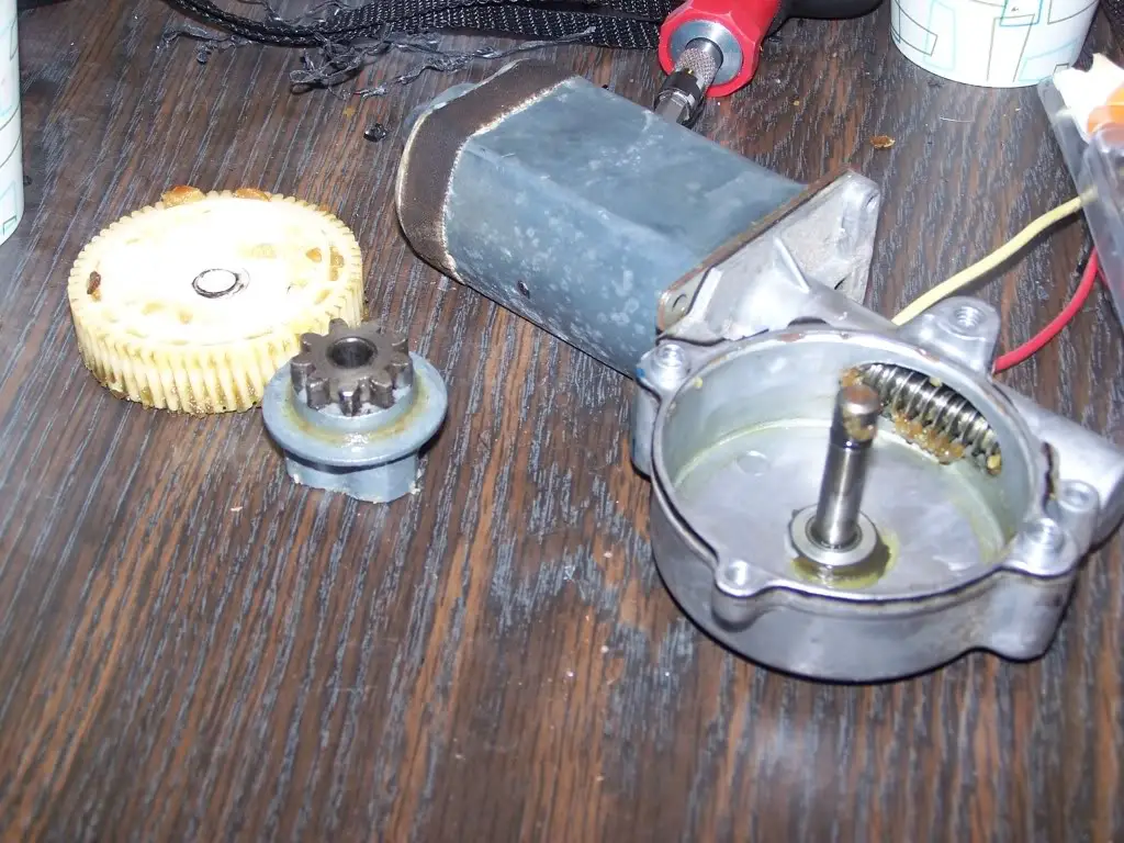

Using a set of needle nose, push back on both sides of the retaining clip at the same time and shoot it across the kitchen. CUSS, ALOT. Find the clip and take a picture of it
Remove metal and plastic gears..Notice a significant LACK of bushings..and a funny smell...
