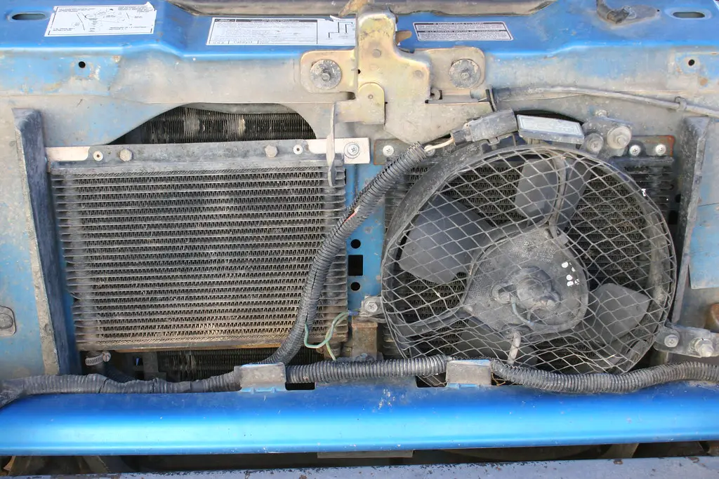

Just an update on the trans coolers... I finally have pictures of what we are currently running. Once it warms up some I'll post some more current temps.. (it was only 80F out today for the high temp).
We have a 24k gvwr and a 30k gvwr cooler, both stacked plate style. The fan is from a 92 geo storm (toyota corolla).. The fan runs whenever the torque converter is not locked up which is basically 45mph or less. We have a hayden severe duty fan clutch which pulls some serious air, but doesn't help gas mileage much..
Close up...
They fit pretty well.
~Mark
