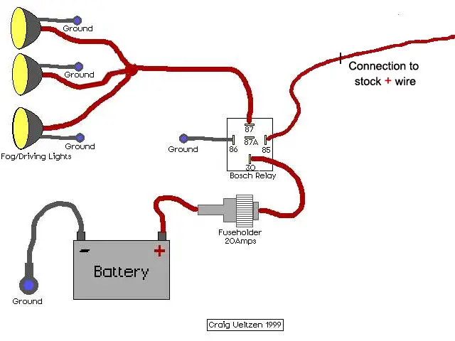

ive got a 93 eddie and want to put auxilary ligths on, i went to autozone and they had alot but i was thinkin about bajas any know anything about them and also can i mount these on the stock roof rack if i drill through it NEED TO KNOW IF THE STOCK ROOF RACK WILL WORK PLEASE
i had some on my x they work pretty well for cheapies. just remember to run a relay with them.
relay wiring,
wire them up like this,this is actually for 3, but after the realy, you can put 4 even, or just 2,
Those baja lights are really , really cheap. I had then on my jimmy for maybe 2 weeks and they already started rusting. They really don't need relays either.
