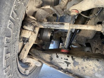

Well since my explorer is just for transportation and I’m not putting any money I don’t have to into it, I made it 95% 2wd. Still have the transfer case, but no front axle or cv axles. Used some old cv axles to remove the outer spindles to put back in the wheel bearings. Hopefully the 4404 holds up like this
It’s not going to hurt the 4404. It’ll just drift in park.
I haven’t been able to make it drift in park yet, I’ve tried. But good to know it could happen some day.
It drifts less when it’s warm.
The AWD in decent condition will slip when in parked on a hill, very slowly it will creep downhill. But an AWD with a completely locked viscous clutch may not slip at all. My one 98 that killed the front diff/gears, that one I don't think will creep any longer. I drove it for about a year without the front shaft, parking many times briefly on hilly driveways. But I never left it long(30-60 seconds) unattended, and I always set the parking brake on hills when I did park on a hill for a long while.
