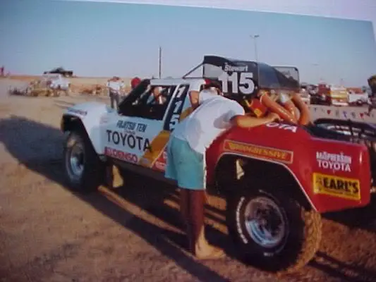

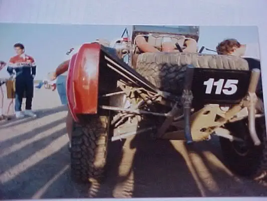

Ivan Stewart ran IRS since the late 80s on his truck!! He had to run with the Class 1 buggies, though.
