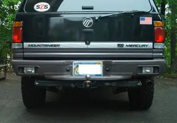

Here is my 1997 Mountaineer Bumper: Reflectors removed and 55w clear fog lights in place. The lights used to hang below the bumper, but kept getting busted.
Thanks, Al.
They work well too, and are recessed about a 1/2" inside the bumper. The lights are mounted into the base of the bumper, with spacers and longer bolts.
Fortunatley, the reflectors simply unscrewed from the gray plastic inserts, but the mounting holes were just outside the width of the lights I purchased. The holes can be seen up close. Wider lights would solve this minor cosmetic issue, but all of the wide lights I found were too tall.

Thats a good looking & usefull mod. I like it.
