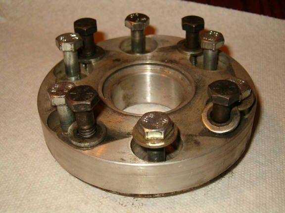

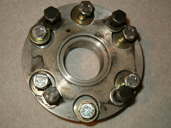

I have this thing. It came with Bryans lift kit, attached to the transfer case.
From what I remember it adapts a toyota drive shaft , or is it u joint ?????
that's just a spacer, so you can re-use the OEM driveshaft with one of the suspension lifts. definately NOT recommended.

I'm almost certain I was told by danderson this adapts a different drive shaft-
notice the 6 bolt to 4 bolt conversion--
Also notice the black residue fron the u joint flange riding on it.
:confused:
I think the 4 black bolts are facing the wrong direction.
:confused:
shoot.
you're right.
I missed that :confused:
so it looks like with that, you can just swap in a 96-97.5 Sploder double-cardan shaft.
and nope, the bolts are facing the correct way.
