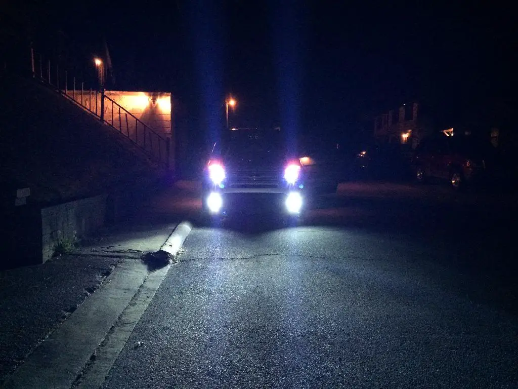

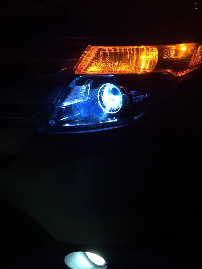

Got the one light fixed and everything is beautiful. Crappy iPhone 5s pics.
