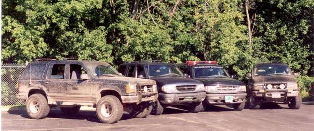

Looking good... I installed a 4" Skyjacker in July (local lift laws limit and X to 4.5") :thumbdwn:
Anyway here is a pick of my '93 on the left..

Update on the explorer. I put in some 6" skyjacker coils, raised the real a little more(springs are saging now) cut up the rear (last trail ride found out stock bumpers cant hold all the weight of an explorer) building a bumper now, through on some rs9000x shocks, through out the swaybars, still need to regear to 4.56's or 5.13's and some extended radius arms... i think a locker in the front would help a little- rears mini spooled heres some new pics
