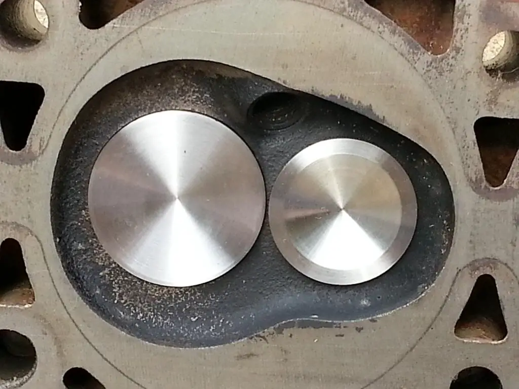

They dont sell larger valves.you would need to have them custom made by manley , you can go with 1.5 and 1.8 but will need to send them a set of valves to copy..cost i believe around $500 for a set..yes they make a good bit of difference but your need to have your heads and lower manifold ported and polished to take advantage of them..also need new seats..add all the cost up and may not be worth it for a mildish NA build
Id suggest getting stock size SI valves believe part numbers 9007&9008 ill double check..but if you go with a stainless steel valve you HAVE to run a bronze guides . .

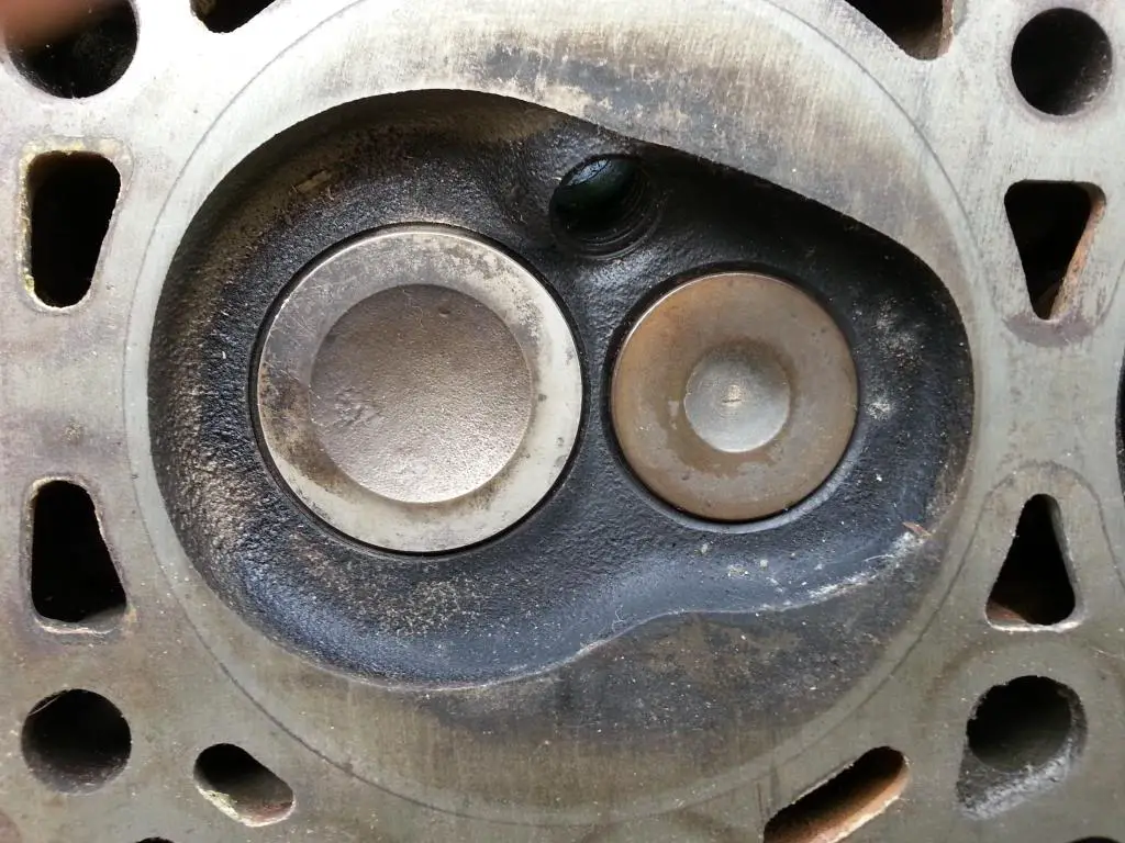

Search ebay for the heads..the true 95tm heads will have large exhaust ports and small combustion chambers..main reason to use 95tm is to raise compression and get the larger exhaust ports that the 98tm dont have ..you can run 90-94tm pistons with late model heads for 10:1 compression,if you dont want 10:1 then 95+ pistons will give you 9:1 but not much reason to look for hard to find 95tm heads. ..
if you dont want 10:1 compression then look for 93tm heads..they have the large exhaust ports but larger combustion chambers . .then run 90-94tm pistons for 9:1..
I wouldnt suggest 98tms,the exhaust ports are smaller
