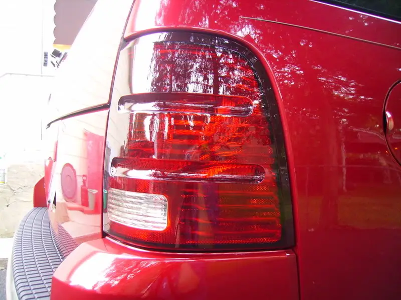

If so chromaclear is by far the best clear..its is expensive but gives the best quality..just as refrence..that what i use to smoke the taillights..
