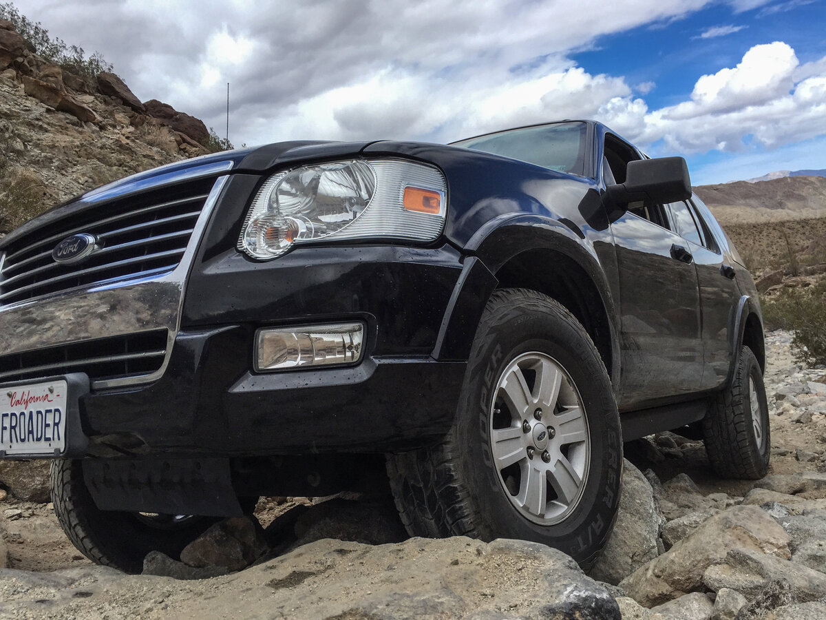

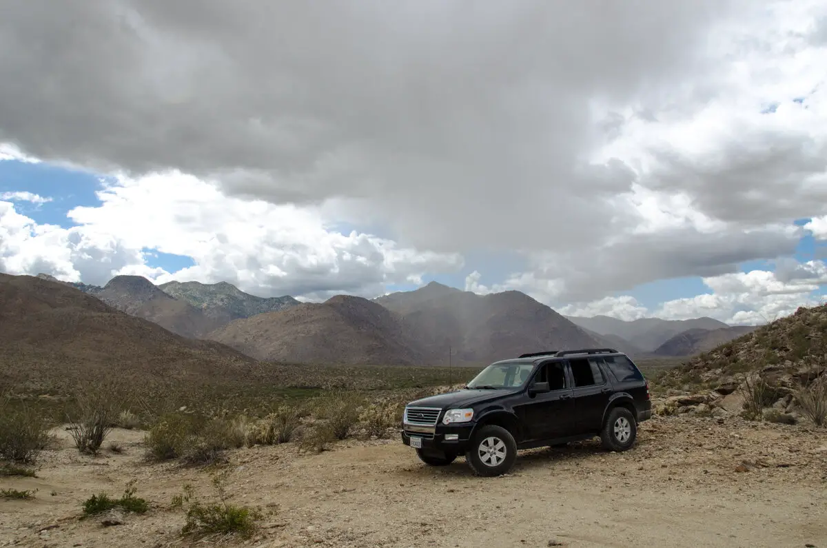

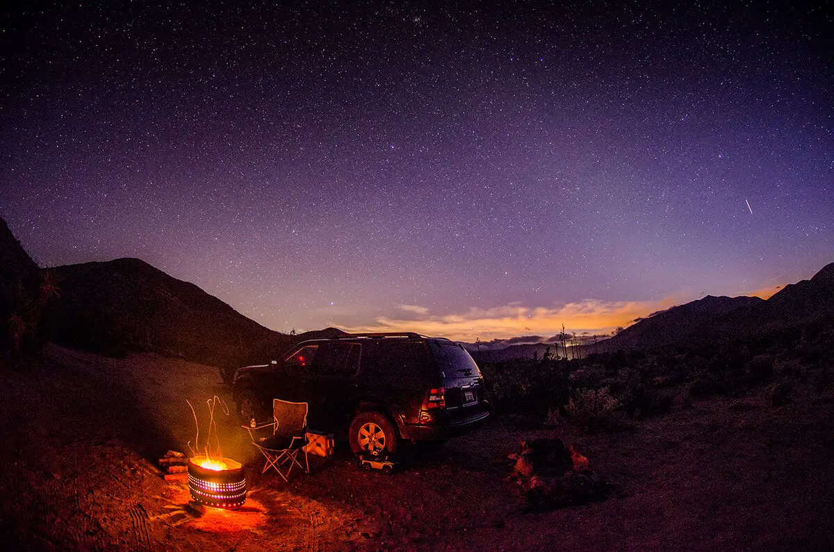

They all have some version of 4wd/AWD.
Will you be sleeping inside, on top (RTT), or ground tent?
I would go for the 4th gen. They are just an updated version of the 3rd, so they are newer and can probably be had with less miles on the clock. They have more interior room than the 1st and 2nd gen and they are better for "off-roading" than anything newer. Not sure if you want to lift whatever you get, but there are a ton of options. There are a few guys who have made a camping rig "overlander" out of them.
Make sure to search around the forum. There is so much info on here that can help you make up your mind.
I had a 2010 V6 with spacers on the front to level it to fit 32s.

Thanks, your truck looks great, how capable is it in moderate stuff?? i am no rock crawler, i just want to carry my gear to remote surf spots, i sleep in a ground tent and use my roof to carry the surfboards or other gear, i didnt look into de 4th gen but i will now, are those trannys having issues like the 3th gens?? I found a servo bore fix kit for the 3th gen tranny so i was kind of still considering a cheap 2004ish Explorer.
