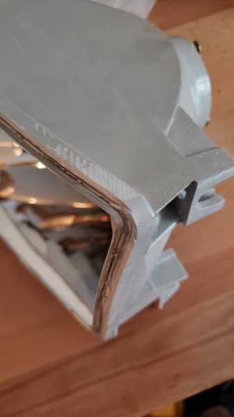

I'm finally doing an HID retrofit on my 2nd Gen Explorer. I was unable to loosen the glue, (even at 300 degrees F, the glue was not budging) so I just cut the first headlight open with my Dremel. Now that I am about to order parts, I am wondering about resealing the housings after the retrofit is done.
I've watched most YT videos on the topic (most of those videos the headlights were heated open), but I can't find a thorough explanation of the best way to reseal my headlights after they've been cut open. Without clips, screws or even a ledge to hold the lenses in, the material has to not only be watertight, it needs to securely hold the headlight lenses in place so they don't fall out from the vibrations of daily driving.

Camera was a little hard to focus so close, but this may provide some reference.

It looks like you cut the flanges off, so I don't know how you are going to glue them back together and get it all lined-up.
