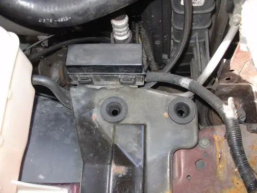

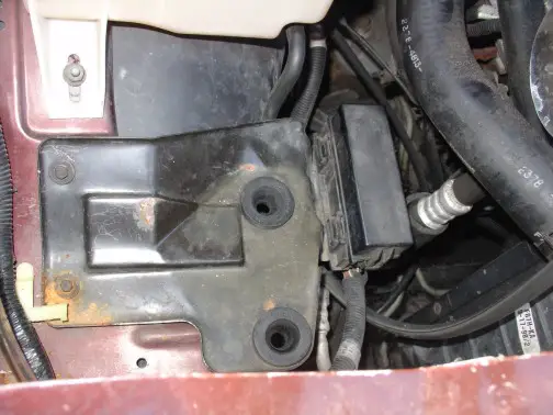

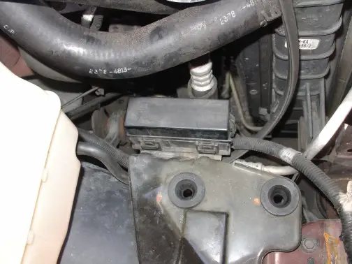

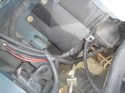

Should be a black globe, in front passenger wheel well, behind the corner light
It will have 2 hard vacuum lines coming from it
It is used for vacuum pressure to drive the HVAC-vent function-blend door
Is there such a thing on SOHC V6 trucks, or is it a V8 thing?
Thanks ....
