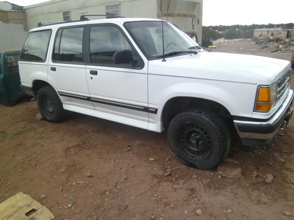

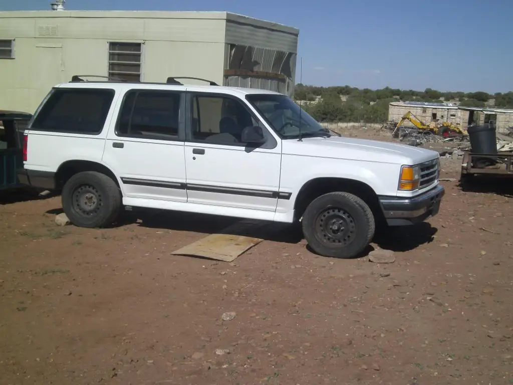

Anyways here are some updated pics of the explorer.

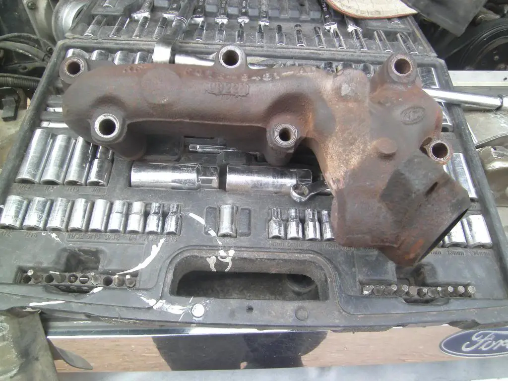

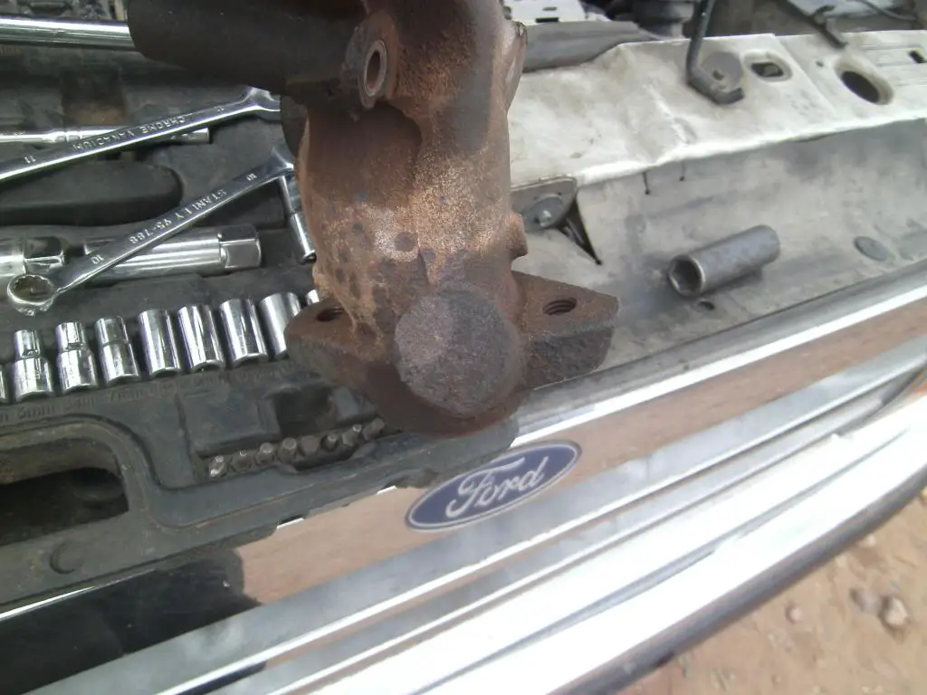

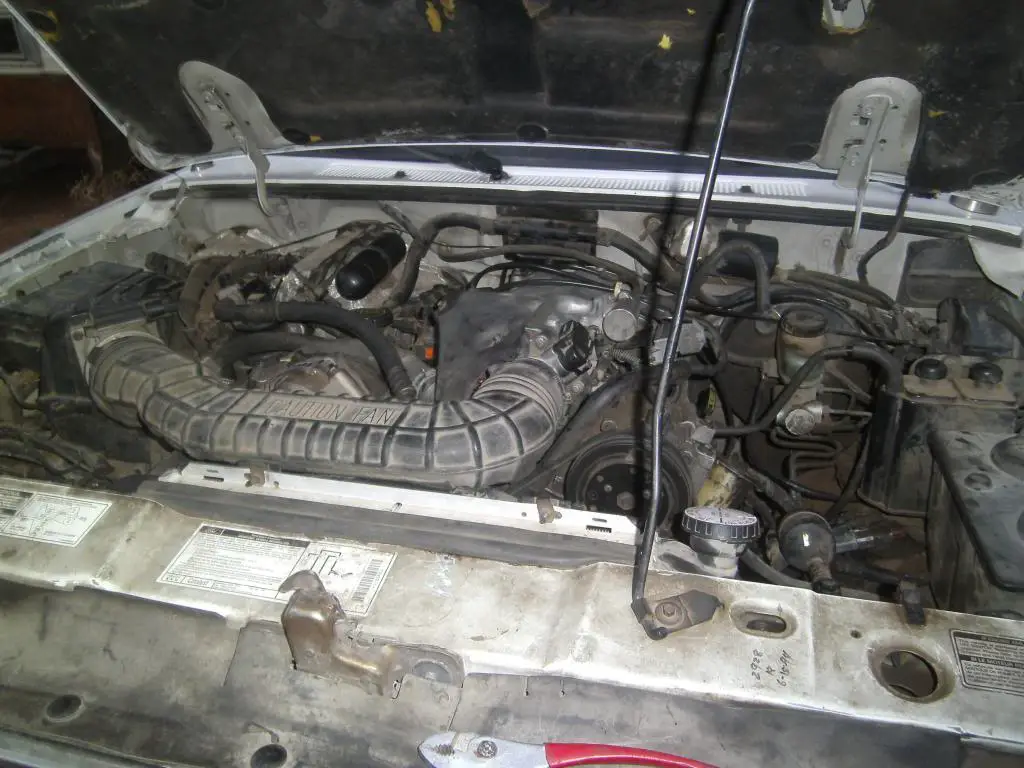

almost finished just waiting for exhaust and intake manifolds installed:

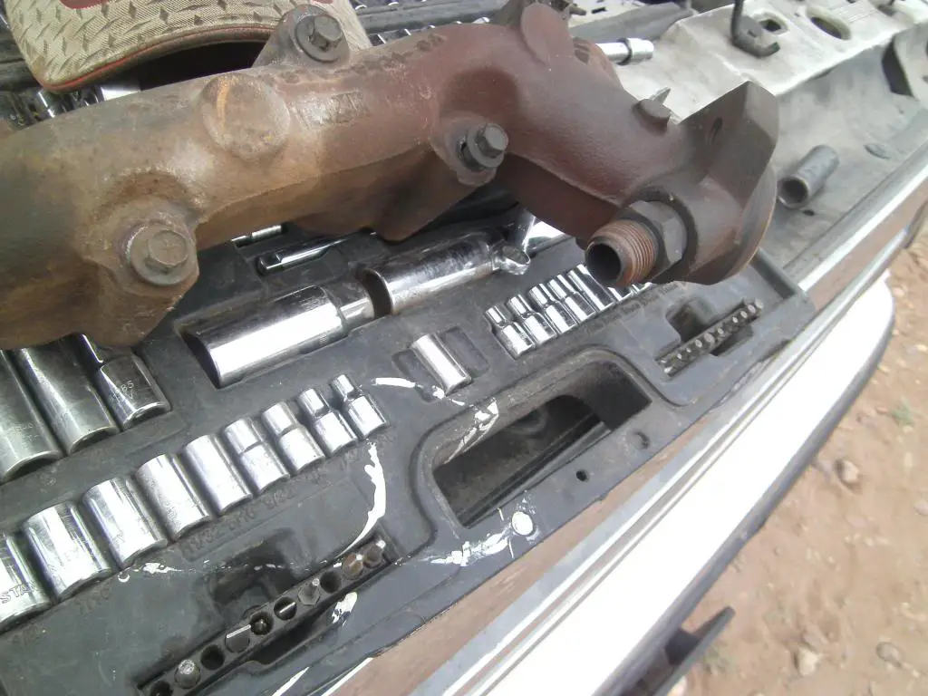

manifold from the parts truck engine:
manifold that goes to the Explorer (sorry about the power stroke hat in the pic LOL I am a power stroke guy even though I never have had a diesel)
the egr cross over tube goes to here:

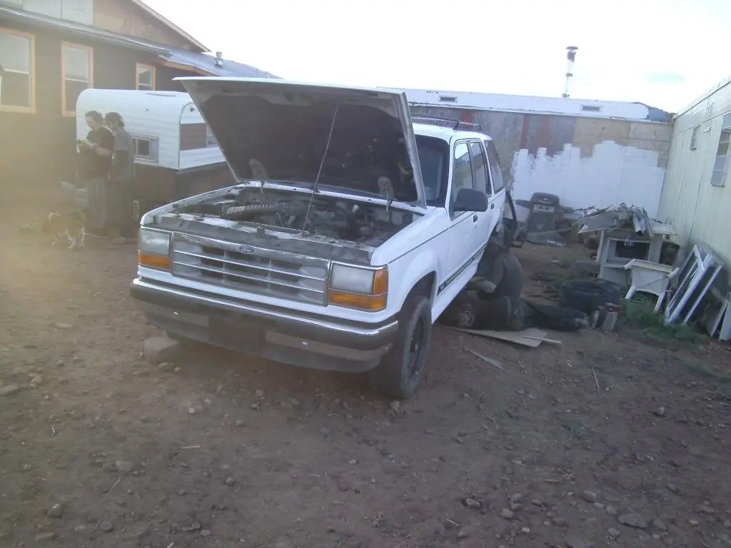

ahh much better to be back together:

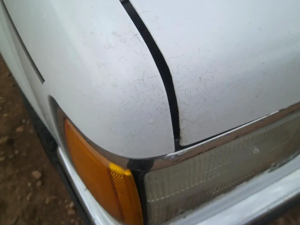

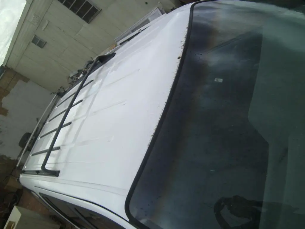

poor paint checkering of AZ I hate that:
the little bit of rust above the windshield:

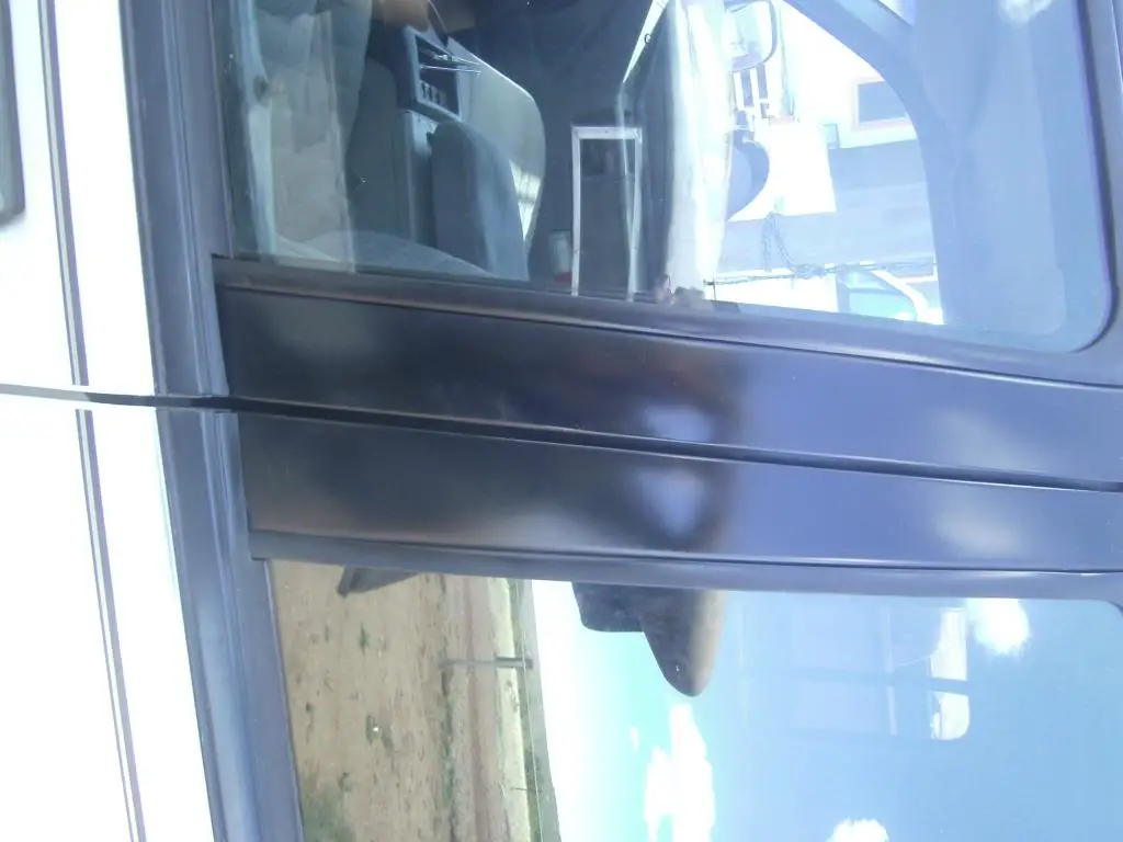

time for a little paint:

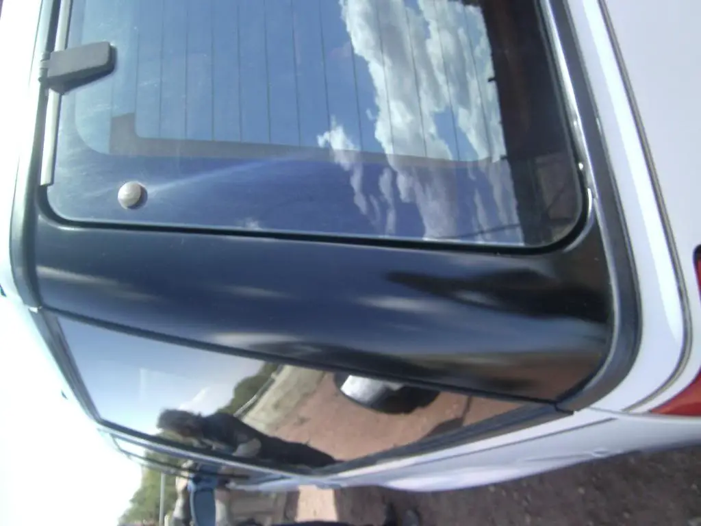

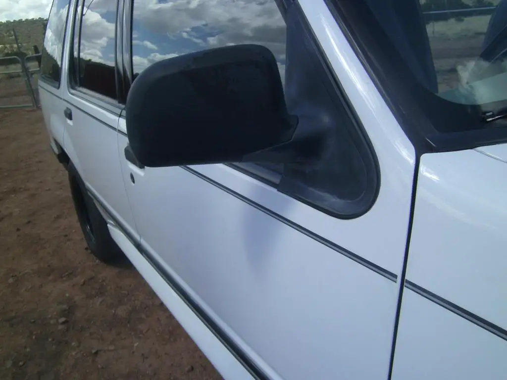

both mirrors looked like this before the wax:

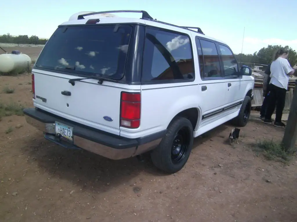

after wax, paint, and such:

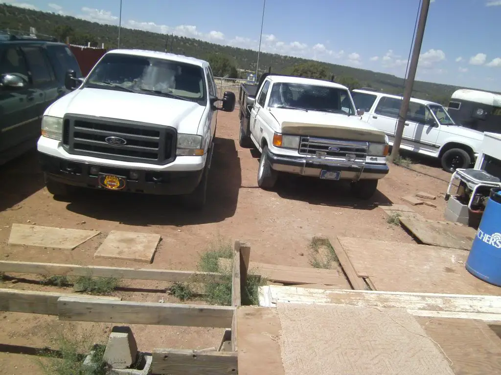

with my mom's 97 Expedition, my dad's and My 02 F250 white and black, and my dad's 89 F250 4x4:
Nice progress! Mov'n fast.
Shoot! at this rate you'll be wheeling that thing next Tuesday!

You thought about going full synthetic with all your oils? I've been reading quite a few threads on how a full fluid system change with synthetic can really REALLY improve efficiency :)
Also, instruct me how to wax like that!! That looks amazing!
Personally I learned from my dad how to wax.
Their is wet waxing and dry waxing.
Also I hand wash my trucks and MCs. I rarely ever get lazy and pressure wash them.
Personally I always Dry wax my trucks and MCs.
I just apply the wax at one panel from top to bottom. By the time I get to the bottom of the panel the top is dry so I just start wiping it off with a soft dry clean rag. Do that on every panel and that's how I get it to shine. Also I get turtle wax. Seems to be the only one that works good. Don't use the stuff at the car wash it sucks (I tried it once on my 02 F250 and it turned out like crap).
My bike never had a single bit of wax or soap and water since the paint job in 07 I got it in 11 or 12 and it was disgusting. I washed it with soap and water then applied wax you would never know that the thing sat for that long.
Also for synthetic oils I will not be running them on any of my trucks. I have a couple reasons for this.
Number one is my dad and I use to have a 1985 Pontiac 6000 that before we owned it never ran synthetic oil. We loved that car so much we decided we would put full synthetic oil in it and I mean I flushed the complete system and everything then put the correct weight synthetic oil went down the road and car stalled out. Turns out I threw a rod in it. No idea how but according to buddies and multiple mechanics it was because of running synthetic oil in a car that never ran synthetic oil. My dad had the same thing happen before also on a old 70s van. So only way I will run synthetic on any of my vehicles is if I get the brand new, know it was running synthetic before, or I completely rebuild the engine.
Only exception to that rule is my MCs. I have ran full synthetic in every one of them and they run and drive great to this day. Of course I have only had 2 brand new Mcs, one that went through a full rebuild and never had oil added, and one that ran it all its life and is about to hit 30K on a 07 with everything mostly original.
My 02 F250 above has been waxed since 2002 when the PO (only other owner) bought it brought it home and then drove to his garage and painted it. He owns a paint shop and I love the work he does. I haven't seen him in a while but if I can I want to apply for a job helping him out as I love doing auto body work.

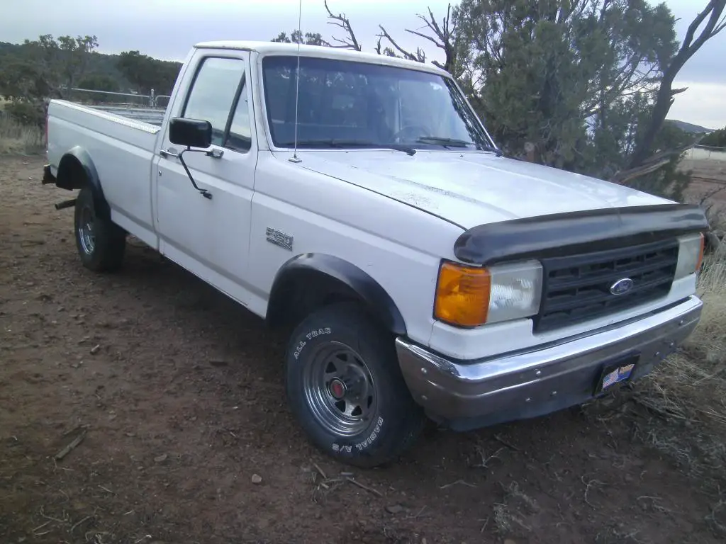

Since I keep talking about my 88 here is a couple pics of her. Her name is White Lightnin
Specs on it 88 F150 4x4 302 reg cab long bed custom package. If I find some 31s or 33s for her I will take the stock 235 75 15s off her and put them on the Explorer. If you guys want I can make a build thread for her also in the full size area.

Also what steps did you take at painting the little plastic pieces on the hatch and the side towards the top of the page? mine are starting to peel and look pretty bad so i want to make them look a little better.
