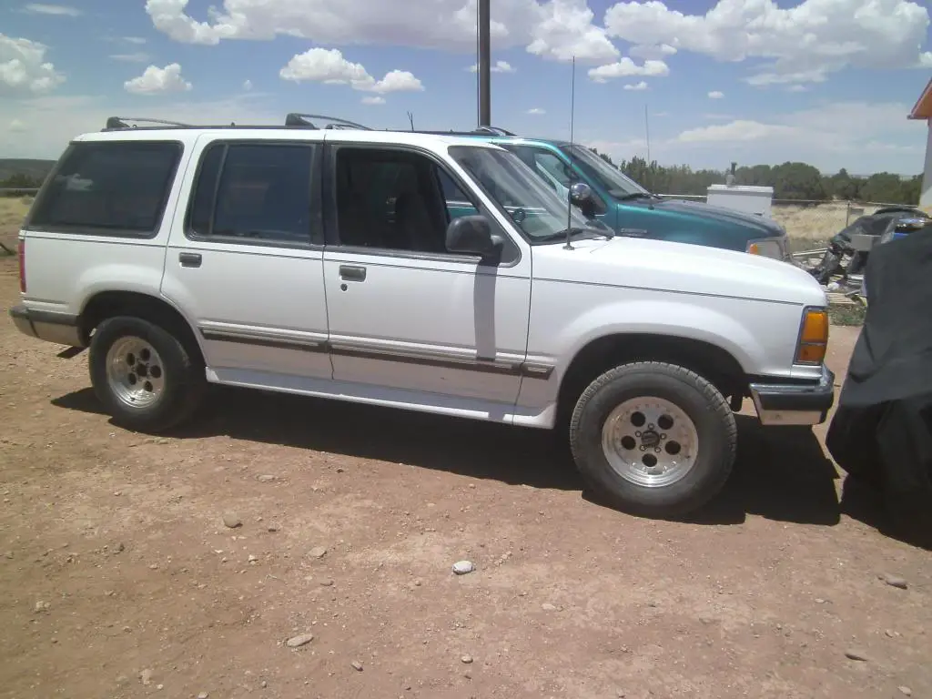

Well yesterday I had picked up a set of 31 10.5 R15s for my 88 F150. I had great 235 75 R15 tires on my 88 F150. So I grabbed the jeep wheels and put my old 235 75 R15 tires on them and put those wheels and tires on my Explorer. Blizzard rides, looks, and feels even better. They don't rub at all anywhere!
Pics
And the new wheels and tires on my 88 F150
If you take the plastic "Tupperware" off the bottom edge you will gain a little bit more clearance and you can easily put them back on if you ever want to sell it.
I haven't decided if I am going to pull them or paint them black. I kinda started to like them. I am worried however about when I take it trailing about breaking them.
Another thing is we haven't decided if we are going to sell it or not. I like having it for getting around cheaper on gas but I always like having a full size ford pick up truck (hence why my 88 and 02 gets the most attention).
