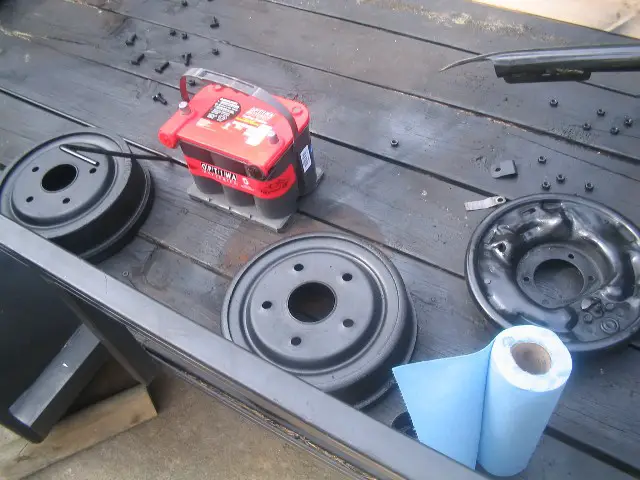

I will probably finish cleaning up everything this evening, and then reassemble it all tonight and tomorrow. I was going back to the junkyard to get those coil buckets off (I was there earlier today and drilled out a few rivets) and started to crank up my truck. It wouldn't crank. :( The battery is dead so it looks like I will be replacing it with an Optima Red Top(for the winch and many lights in the future). It will probably cost me about $110 @ Advance Auto, but I might as well upgrade now instead of spending more money later. Anyways, I will have to wait on buying anything else for this right now. :(

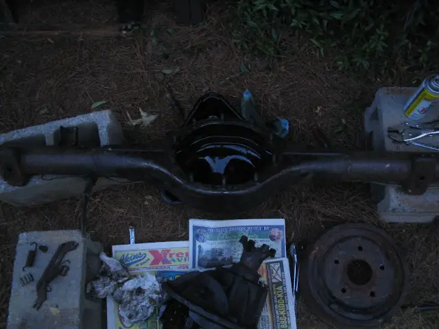

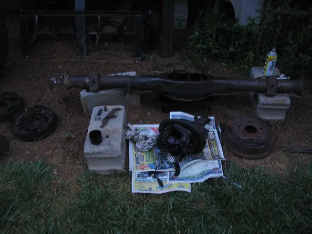

Here's some progress pics...more tomorrow after it's all cleaned up and painted. :thumbsup:

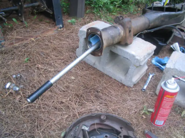

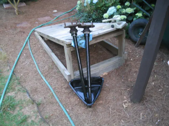

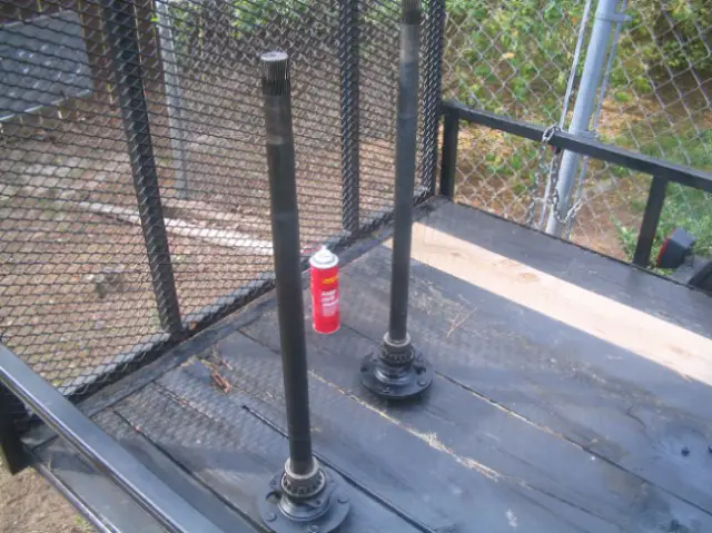

I got all of the axle cleaned, painted, and will finish putting it together tomorrow. I used brake cleaner to clean it, and used a jack handle to push in the rag into the axle tube.

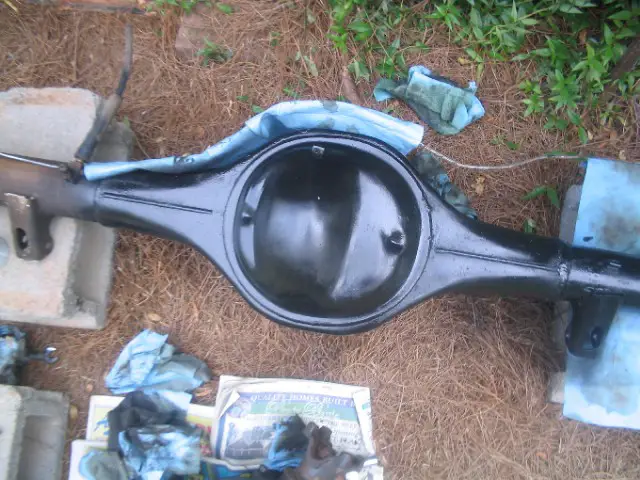

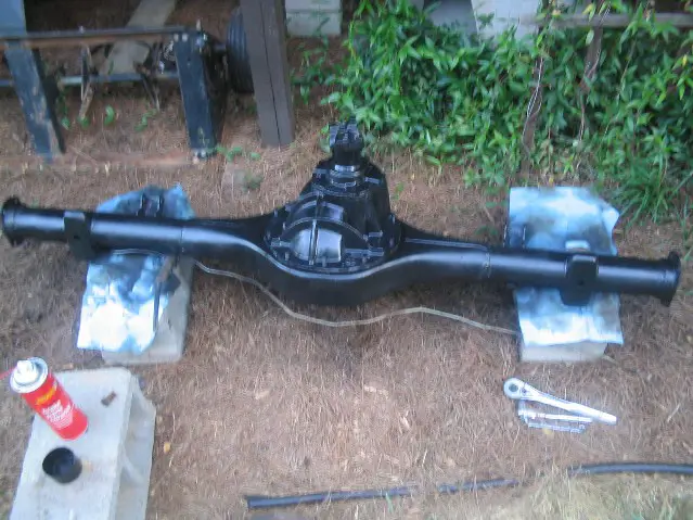

More pics:
