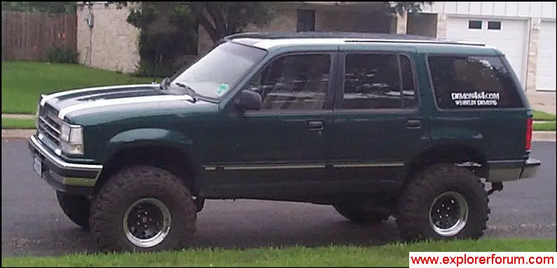

I checked with the Ranger boards as well and I have found nothing about an extention for the manual T-case. I might cut down the Body lift a bit and Trim more out of the fenders. As of Right now I have no rub at all with the 36"s but still plan ot trim anyway.
Where are the pics of the 36's?
