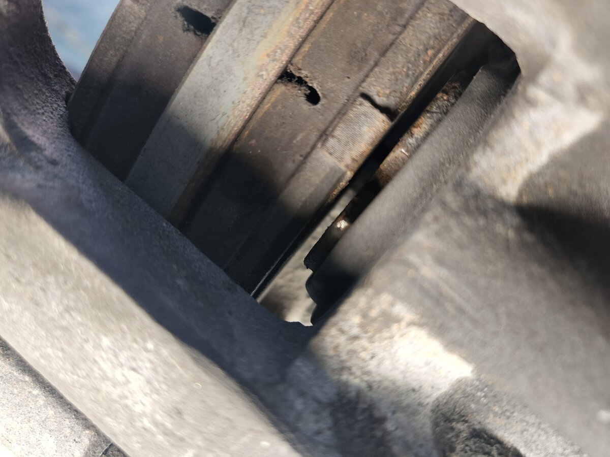

Afternoon all, have been having an issue with our recently purchased rig where the pedal has to be pumped to work in a decent fashion. Figured it was air, went to bleed and found the fluid was red/black... got to flushing all that out. On the rear I noticed the caliper piston is a solid 1/8th inch off the pads...
Took it off to "unscrew" the piston figuring someone over tightened it last brake job. Problem is, if I back it off one half turn to line up the notch for the little nub on the pads, it is too far out to fit back on! Pads are near new, and it has always been my understanding that caliper pistons should back off only 4 or 5 thousandths when the brake is released, not anything like these are.
I have attempted to set/unset the parking brake several dozen times as well, but even fully down/on, the piston does not touch the pads...
Any help or advice on how to fix this is greatly appreciated!
