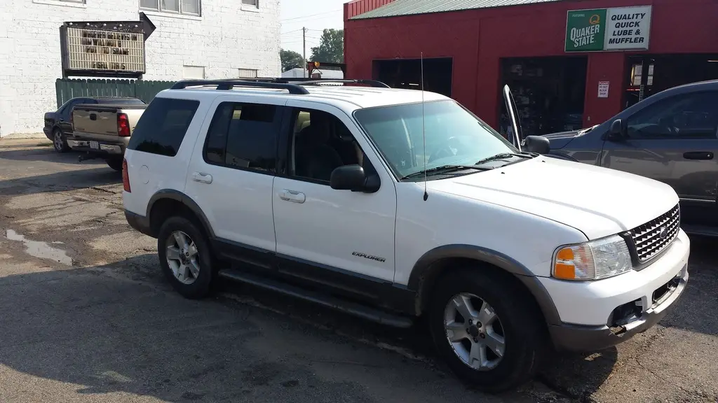

I just picked up a used 2002 explorer. it's been used and abused, but i believe it has a lot of life left in it! the transmission is the only issue with this vehicle. I have put about 150 miles on it in the last two weeks and it is always the same.
1st start of the day, let it warm up for 5 minutes, until the trans temp gauge is in the middle. drop it into "D" and pump the gas 2-3 times until it "catches". then it kind of shakes a little, then it proceeds to drive. "R" works right at start up no problem. nothing wrong with reverse.
My truck also has the 1st-2nd high rev/clunk into gear. 2-3 is smooth, 3-4 is smooth, and in general it drives fine. My O/D light is always flashing, pushing the button does nothing, and the transmission never shifts past 4th.
I have pulled the diagnostic codes P0731-P0735 which is "incorrect gear 1,2,3,4,5 ratio. The OSS in the back of the trans was bad, i replaced it, and that code went away, but it did nothing for the incorrect ratio codes. (what is the most commonly broken part that would cause this "incorrect ratio" issue?)
I have built a few cars in the past, engine swaps, motor rebuilds, but very little messing around with auto transmissions. i would like to fix this myself, but i am unsure if i should try to drop the trans pan and replace parts (solenoids perhaps?), or other such items, or try to find a good used trans to drop in.
i have searched/read many post about these issues, but what i am looking for is people who have walked down this path and if fixing the trans worked long term, or if i should just cut my losses and drop a rebuilt one in. At this point i think the transmission will no longer go into drive, and i have to decide what to do soon considering i bought this to be a winter driver.
