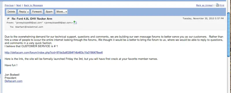

Tell me about it.. I know aaaaallll about this new forum they're posting up, which by the way is released this friday.
EDIT -- Oh you'll get a kick out of this. I just received another email after asking them to please respond with the proper part number.
Check out the return email address from the site.. SERIOUSLY?? mature, real mature.
