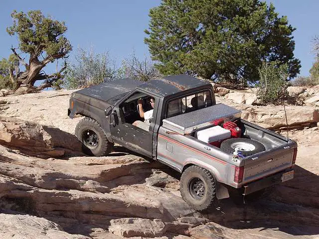

was it RockRanger that did something simular to this?
Yes on his 86 ranger
