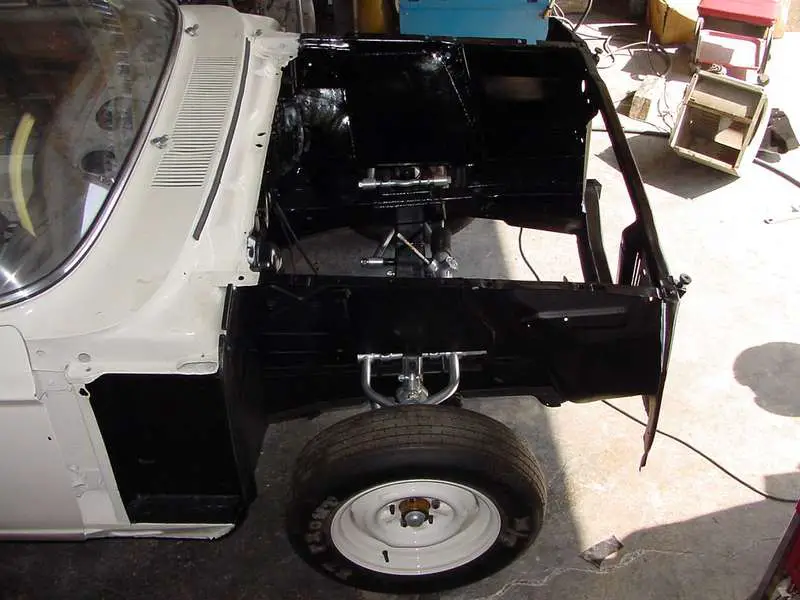

Thanx, I had to switch to .023 wire from .035, the big thing is that you have to "pulse" weld meaning to pull the trigger and release, to keep from burning a hole in the sheet metal.
It's a pain and I'm by no means a professional, but I do enjoy what I do and love the ablity to learn every time I get into one of these projects.

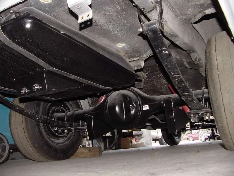

A peek at the custom built fuel tank and Currie rear axle:

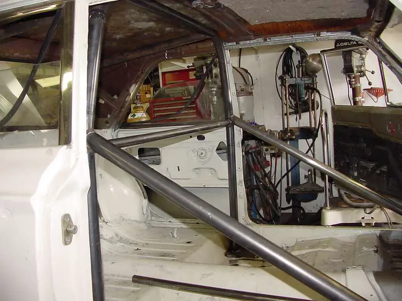

Here is the roll cage being mocked up, I'm having a little conflict with the customer about weather I should run the rear bars straight (I already have them notched and ready to go in) back off the main hoop, or run them across the roof then down through the package deck (cleaner, but not as functional in a roll over), so as or right now things are up in the air :rolleyes:

Looking good. I think the straight bars from the cage to the rear would look better straight myself. Not to mention (like you said), more functional.
Well it didn't happen that way as you can see he wanted the bent bars to hide the cage as much as possible, oh well it's ok, it's more or less going to be a show-off type of car it won't be really used for what it being built for.

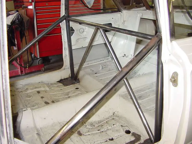

Well finally done with the cage, started on the battery box in the trunk but ran out of Argon :rolleyes:
Oooo, just want to run my finger over those welds.... :D
