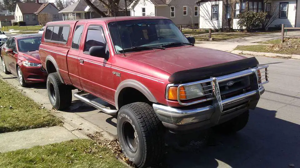

the trucks got these ****ing 33" tires man, thats my only concern. their kinda big lol.
its 3.73:1 axle ratio and its a limited slip axle.
the trim model is XL supercab, and man let me tell you it looks ****ing beast.

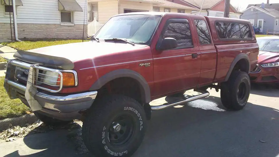

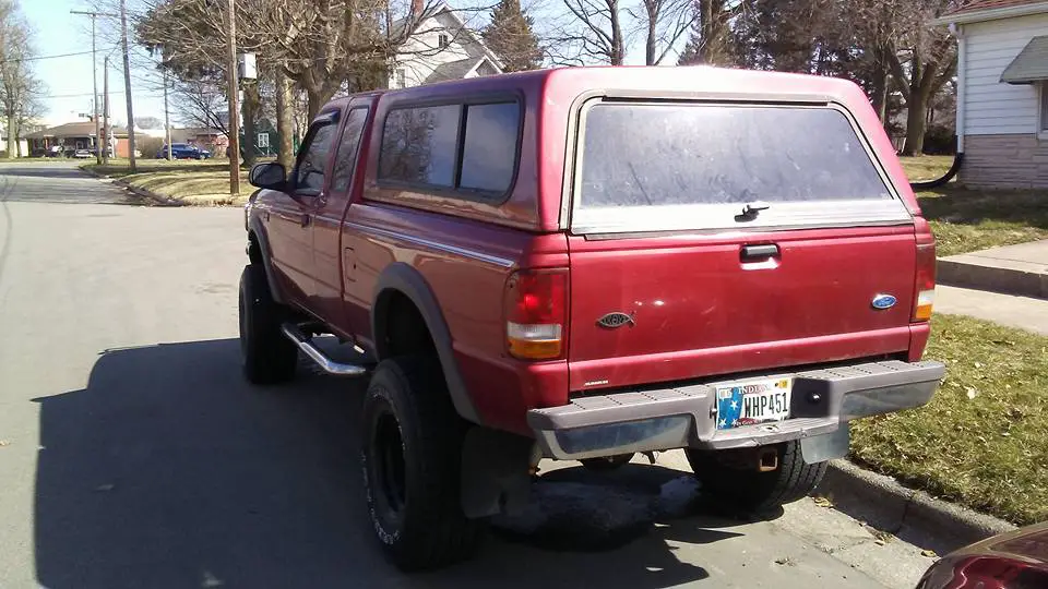

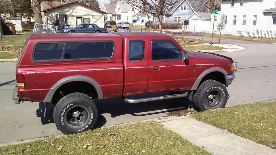

attatched are some photographs.
thats the correct formula for calculating power. im a mechanical + automotive engineer, i can back his claim up.
210hp would be perfectly fine by me. does the SOHC make more power? i can buy one of those and drop it in,in an afternoon assuming the wiring is the same.
