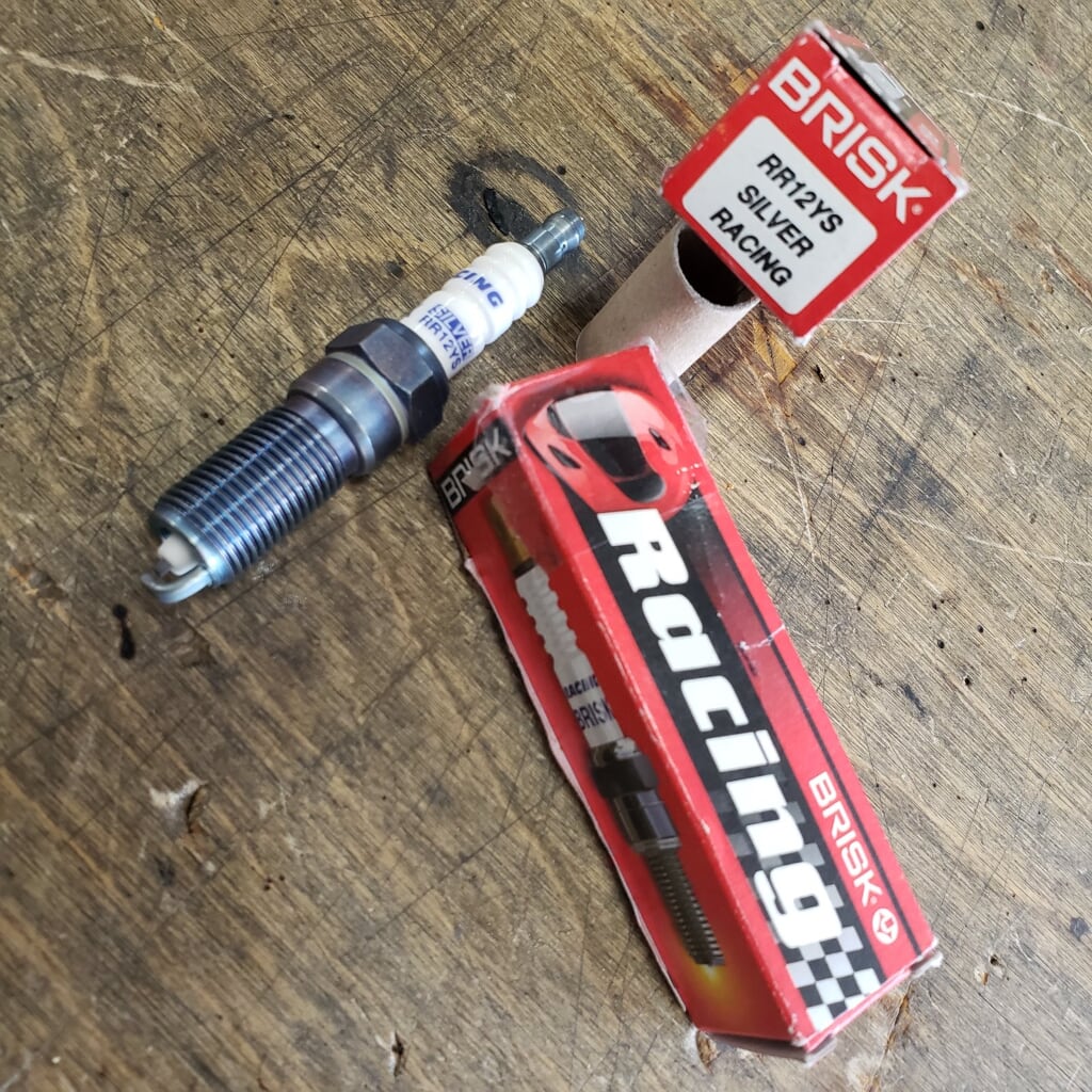

So on the advice of a pretty good local tuner, I decide to try out some Brisk spark plugs (Brisk Silver Racing Spark Plug Online, High Performance Spark Plugs). There wasn't necessarily anything wrong with the 542s I was running, but with the power goals and modifications I am shooting for, I wanted to attempt one additional step colder of a plug (OEM was 534s, heat range 6, 542s are range 7) by going heat range 8 to see if I can squeeze some timing out of her. Although I have limited personal experience with Brisk, a lot of top shops and tuners use these things. I did some research and on the advice of that local tuner, decided on trying out the Silver Racing plugs (hey, it has Racing in the name, so it MUST be good, lol). They are heat range 8, which is 2 steps colder than OEM and it remains to be seen if I can get a bit more timing out of these or if they will just foul out. Oh, and they are Made in the USA so that's a plus, right?

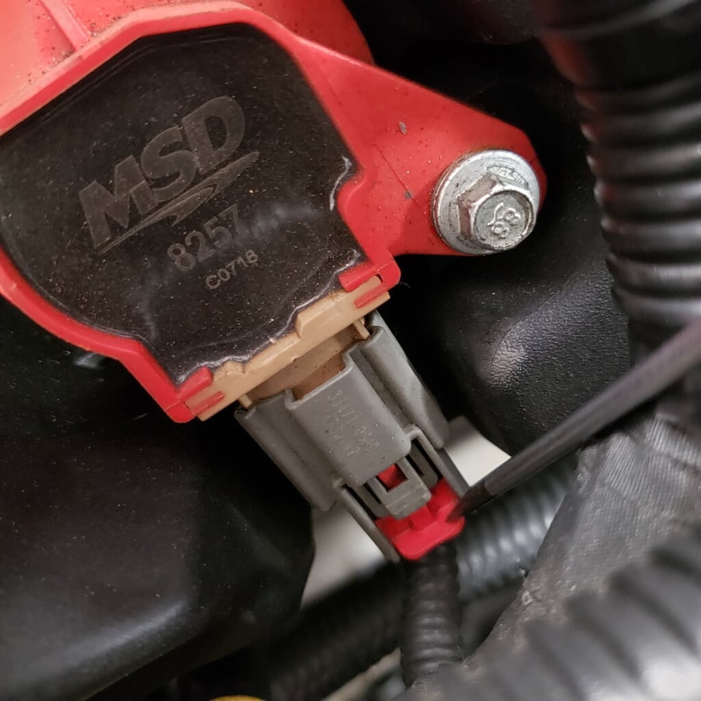

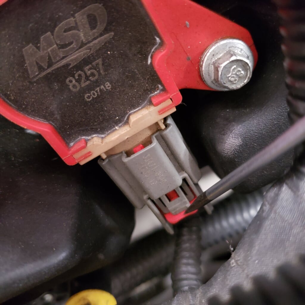

First thing is getting those connectors off the coils. Slide back the red clip on the coil connector, it's easy enough with a small flat head screwdriver:
Then just press the clip retainer and slide off the connector. After disconnecting that, use an 8mm socket to remove the coil retaining bolt, then pull out the coil. Even though I only complete one cylinder at a time so as not to confuse things, I still typically mark the coil with a sharpie identifying which cylinder it came from.

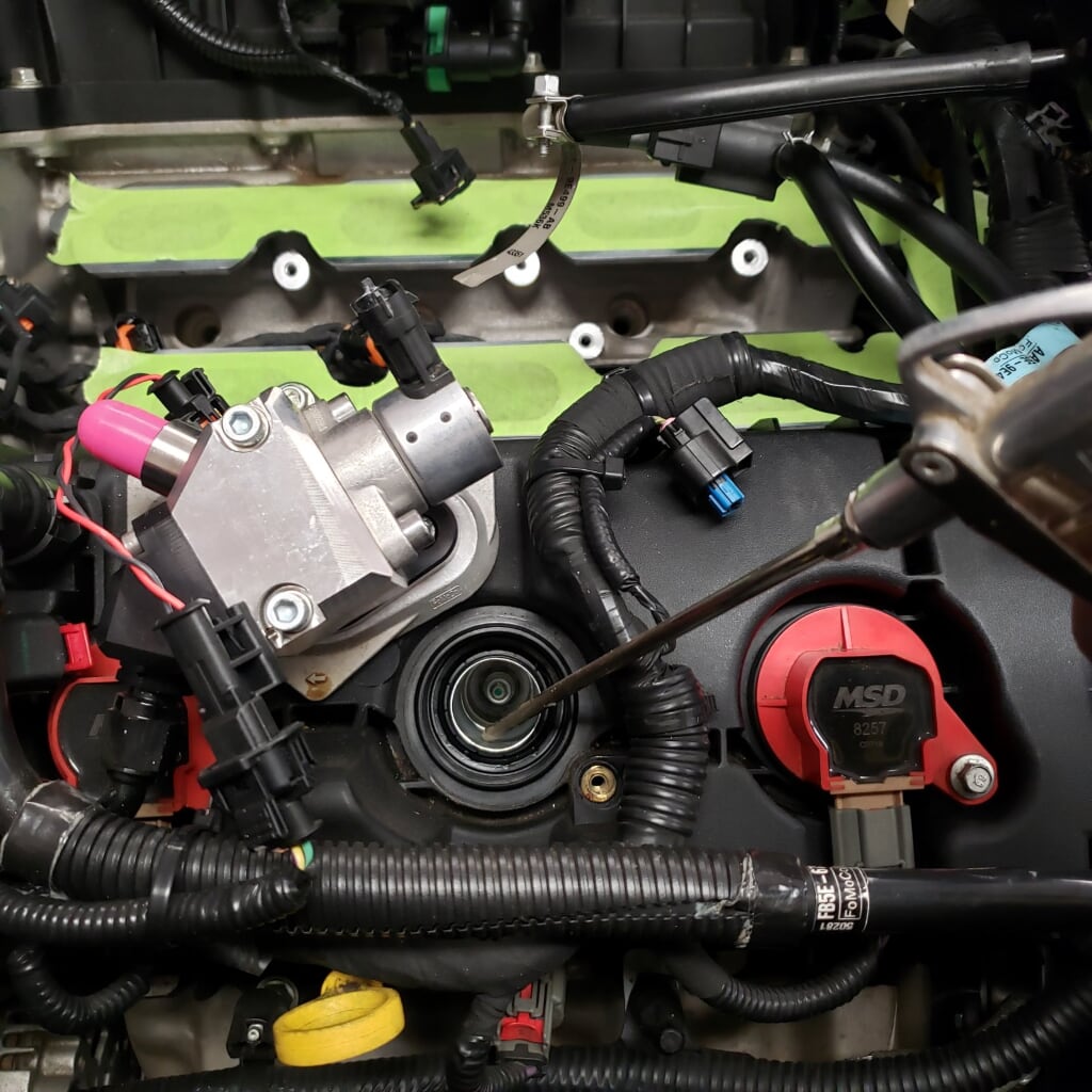

Before you take out the old plug, it is important to use some air to blow out any debris that may be residing in that spark plug well so that it doesn't fall into the cylinder. You'd be surprised how much junk gets blown out of there, despite them being "sealed".

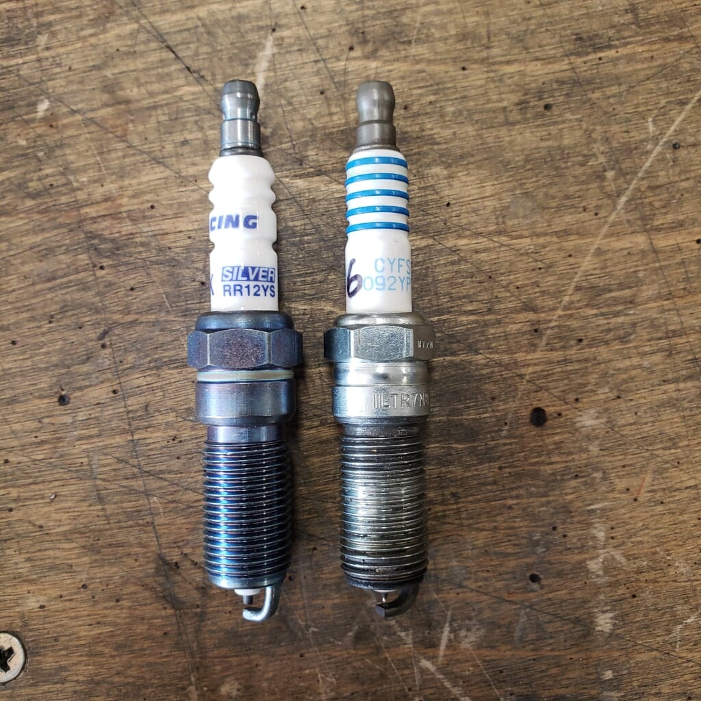

Anyway, here's the new plugs:
Side-by-side comparison of the plugs:

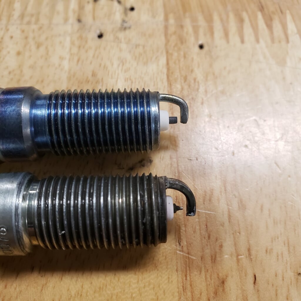

Tip design difference:

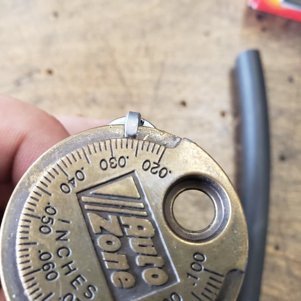

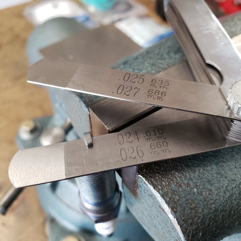

Onto gapping the new plugs. I had the 542s gapped to 0.26 and went with the same on the Brisk plugs.

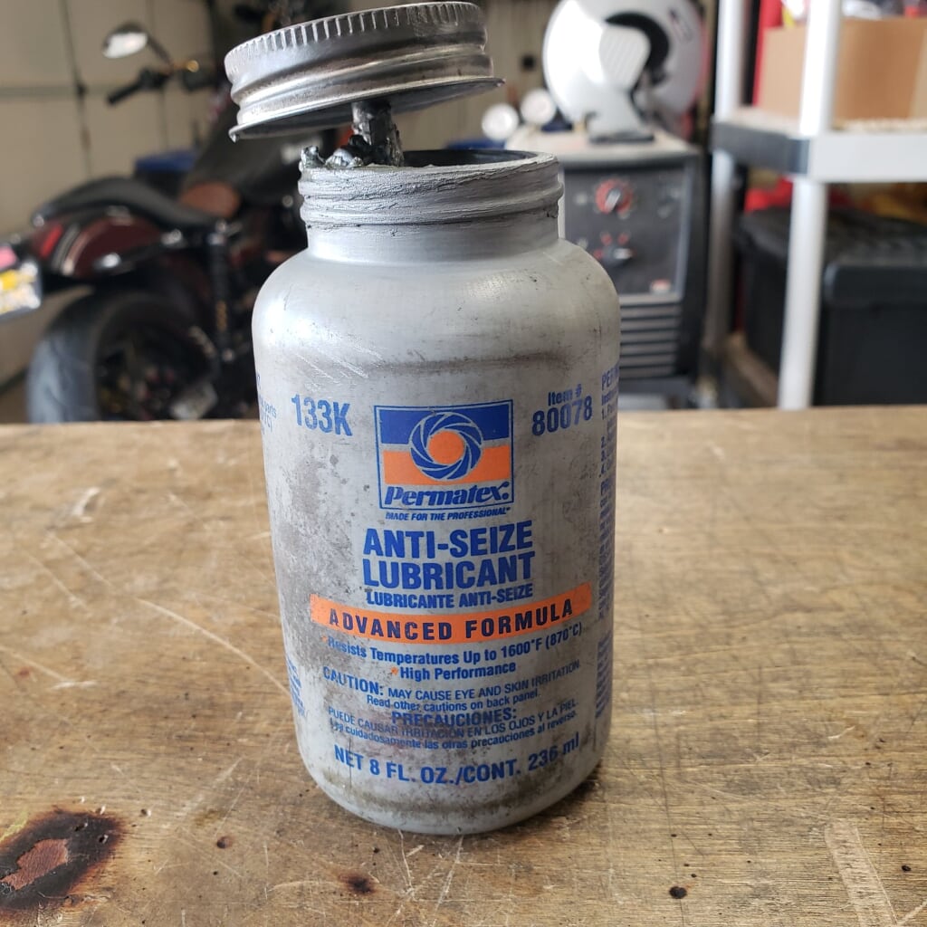

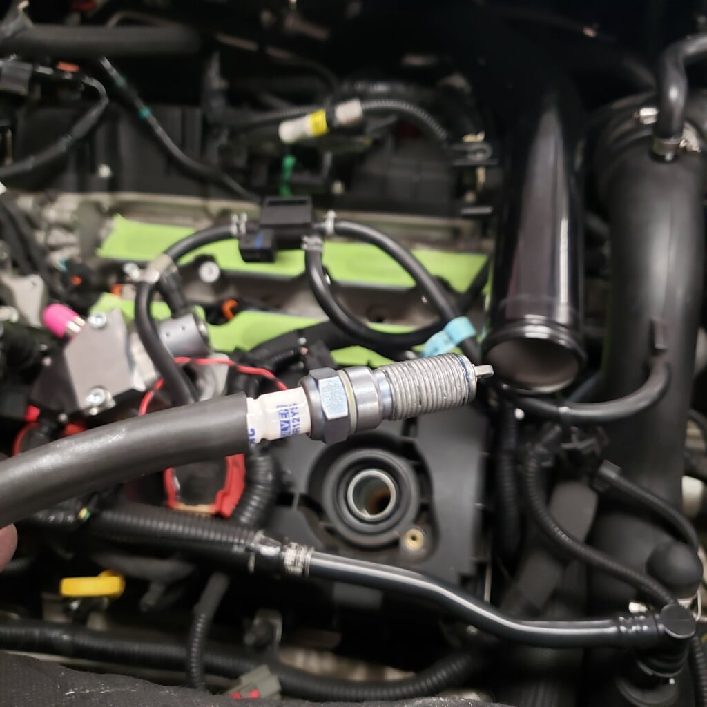

I use an old piece of rubber hose to put onto the end of the new plug as it makes it a bit easier to install by hand into the well. But before I install it, I give it a good thin coating of some anti-seize. You will thank yourself later if you do this, trust me.

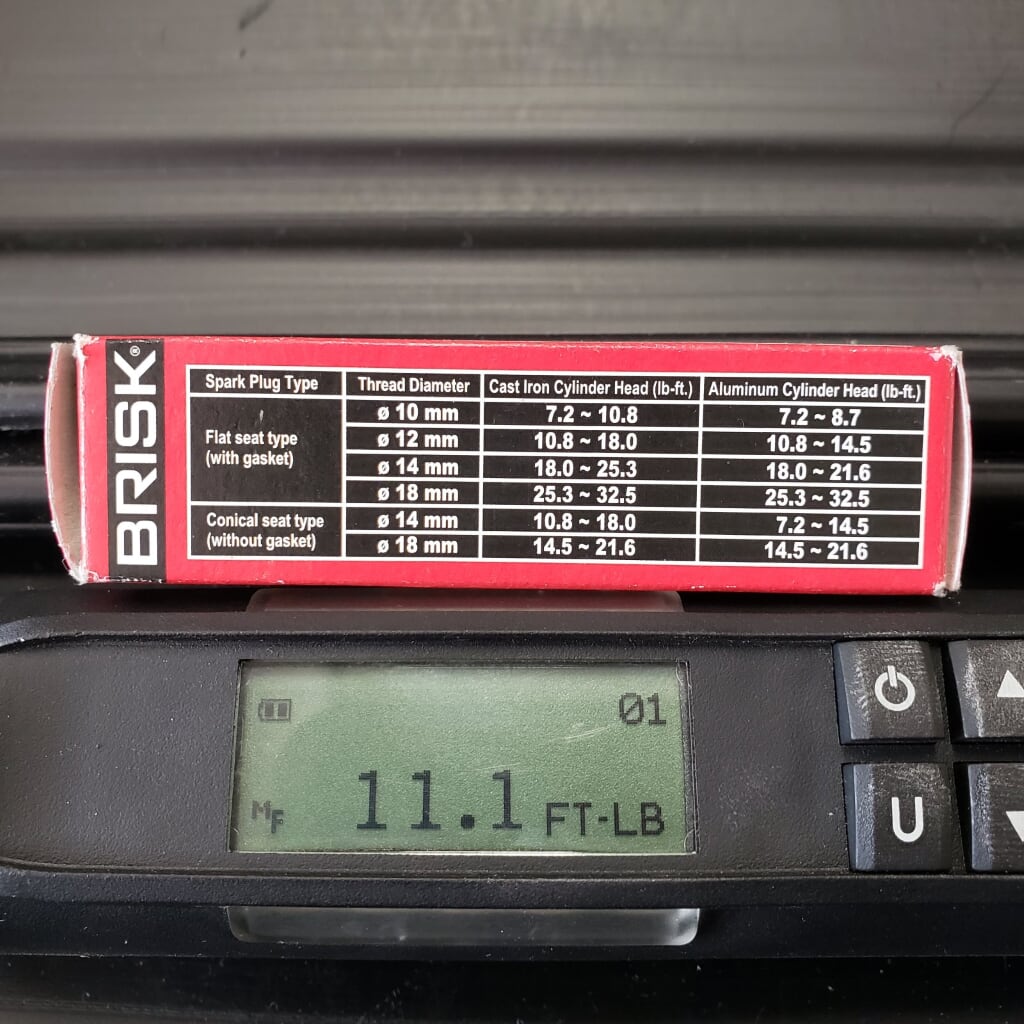

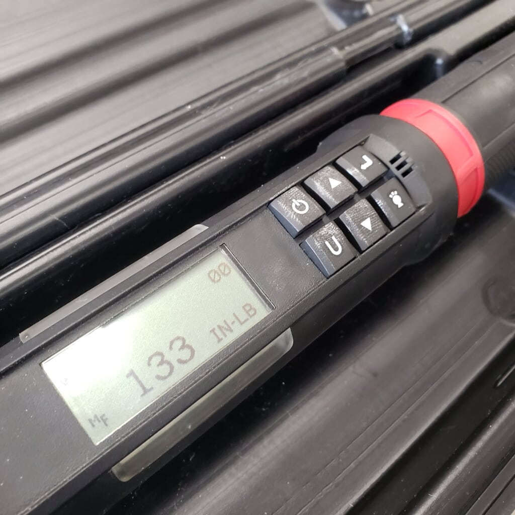

Factory Service Manual says torque to 133 in-lbs, not much, I know.
If you convert the in-lbs to ft-lbs you get 11.1. Comparing to the recommendation provided by Brisk, it falls right in line (the plugs are conical seat, 14mm thread diameter going into an aluminum head).

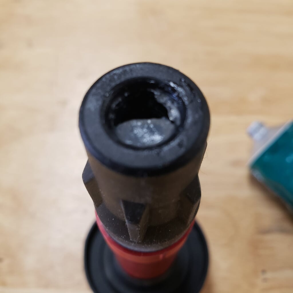

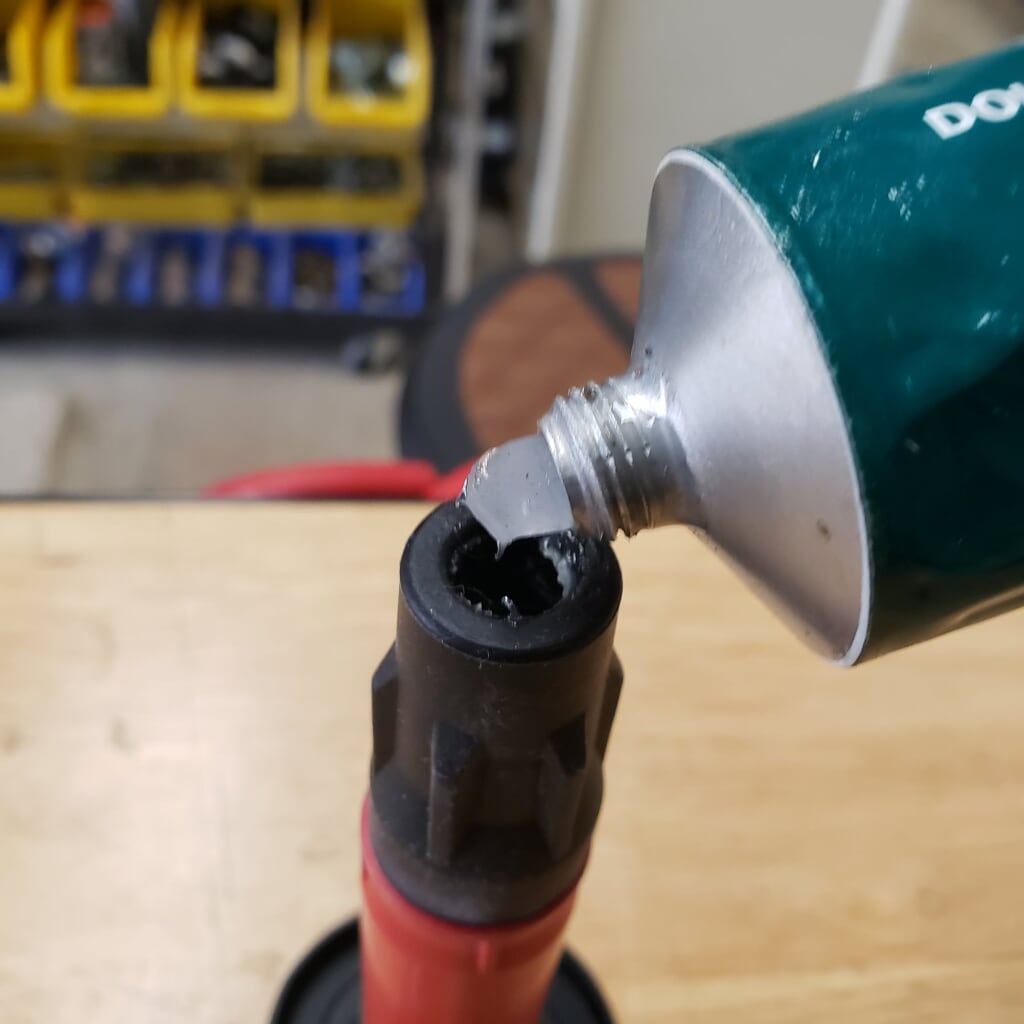

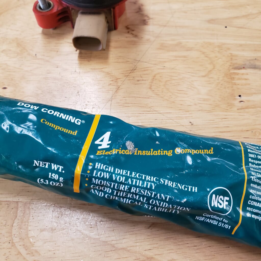

After installing the plug, make sure to use a small amount of dielectric grease inside the coil to help keep moisture out as well as ensuring it doesn't adhere to the plug and become a nightmare to remove for the next plug change. In the photo showing how much is coming out of the tube is the amount I usually use.

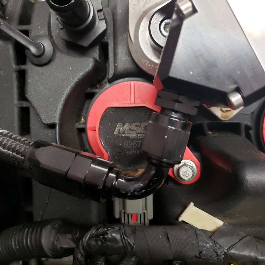

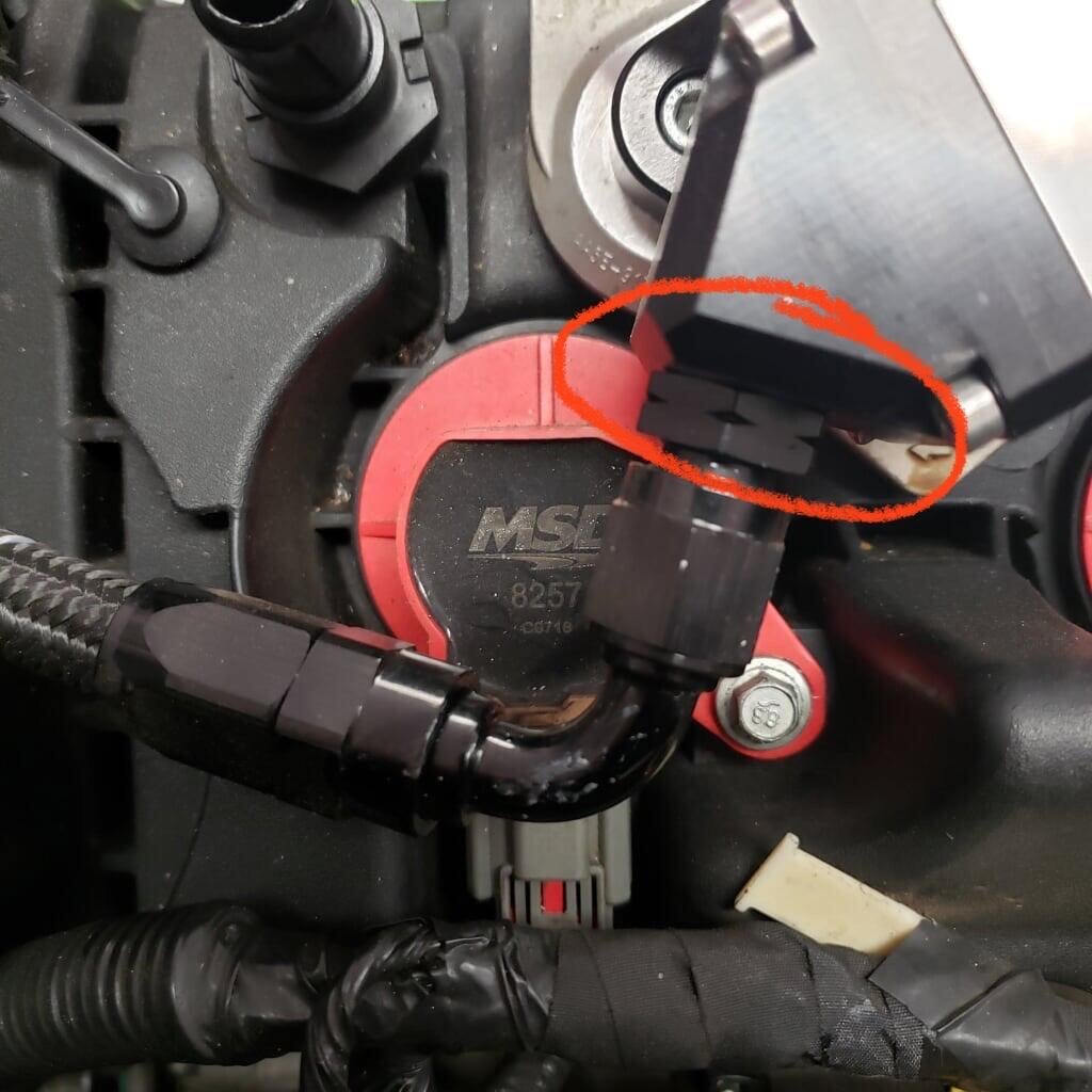

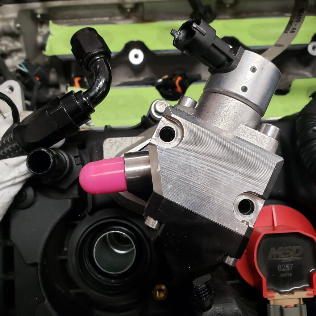

2) If you have an XDI HPFP, you're going to have to remove the low and high side fuel lines as well as the top 2 bolts to spin it a bit to access the coil on cylinder 4. I think I heard XDI had a redesign, but can't confirm that.
Anyway, as mentioned, I'll keep you folks updated once I get her back on the road. After doing some research on the Brisk product line, I gotta say, I'm fairly impressed so far. Now the proof will be when I get some miles on 'em.
EDIT: It's been brought to my attention that there is an easier way to get to the #4 coil if you have an XDI HPFP. Simply remove the low side fuel line AND remove the low side -6AN fitting out of the HPFP body (there is just an o-ring behind it) and that will give you enough clearance to remove the coil. No need to remove the high side, 2 top bolts, or spin it. I have not done this method yet, but will the next time I do a plug change.
