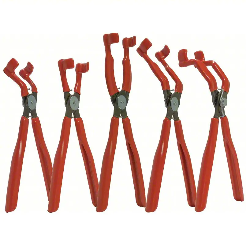

I use a tool, grip the boot gently, always try to rotate the tool a bit to loosen the boot first, and apply a gentle in-line pull. I think these wires take heat and then simply bending them can cause a problem. The carbon core breaks down and cracks I'll quit whining, I got one tool that works but the angles are still tough, and the boots get baked-on. I suppose I could upgrade to a set of these to get the right angle to better grab them:
I can't justify the expense of those and the lifetime plug wire guarantee works. Now I have saved a full set of wires and have them ready when I need them. I wouldn't attempt a plug change without
