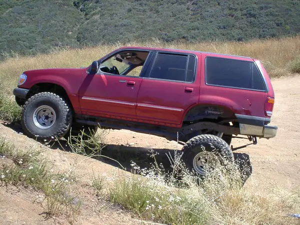

This is the exact look I'm going for. Everything is perfect on this truck. Do those look like 33"s or 35"s?:

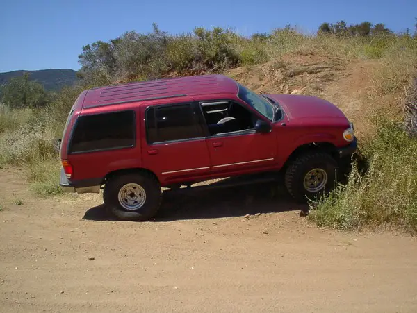

Just FYI, heres a pic of my truck thats gonna get the lift:

your all forgetting he said this is 2wd. There for a easy spindle lift is also an option. along with a TT. plus the SOA in the rear and hes rite around 5" all around. some trimming and 35's are possiable.
We didnt forget. First reply:
.. maybe some 2wd spindles + torsion twist for the front, and SOA in the back.
i forgot, lol. sometimes i even forget that there is such an animal as 2wd trucks, haha.
