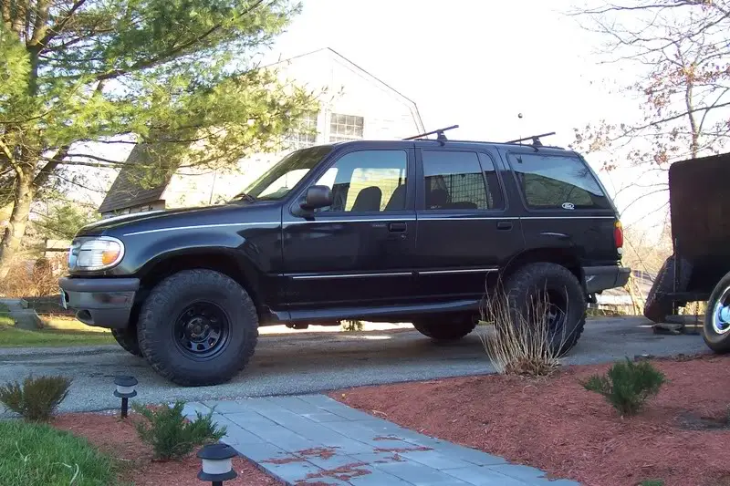

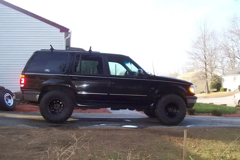

I found a picture. After searching and searching..
Thats with a TT and Shackle.
If you look closely you can see the amount of trimming thats would have to be done. ( He wasnt willing to trim that much)
I wouldnt have a problem cutting that much out Ive trimmed alot more on other vehicles.

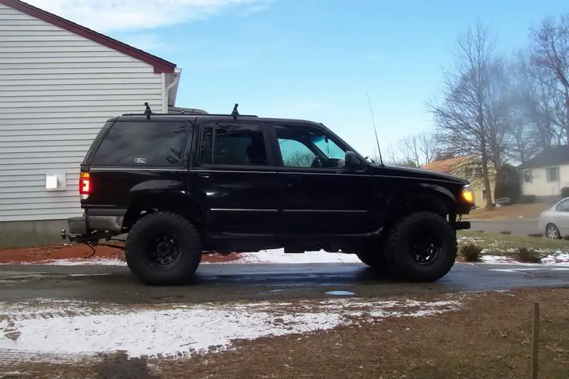

This is after with the 3" BL , TT and Shackle
You can see the differance it made and the extra room obviously.

No there is not a bl installed yet. Just TT and shackles. I just threw on the wheels and tires for the hell of it to see how it looks. Can barley turn the wheel. If I was to drive it like that I would have to do A ton of trimming. I will be putting the BL on sometime next week.
Basically, that picture is of his explorer with 33s, but he cant even drive it like that.
So i think youre gonna have to do more than just a little trimming
I dont mind cutting out some fender. Taking a BFH to the floor board/wheel well area and customizing the inner fender well. They fit and If I remember rite he said they rubbed like crazy and he couldnt drive it like that.
