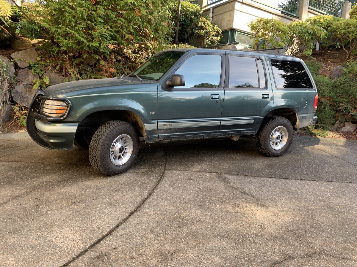

Hey I have a '98 and I've done shackles+add a leafs in the rear and cranked the tbars all the way in the front. I still have 29s and I'm looking at getting 33s, but I don't want to do a body lift since I have a push bar front bumper and I don't think that would work with a BL. Does anyone have experience with fitting 32s or 33s with a similar setup/no BL? (pic for reference)

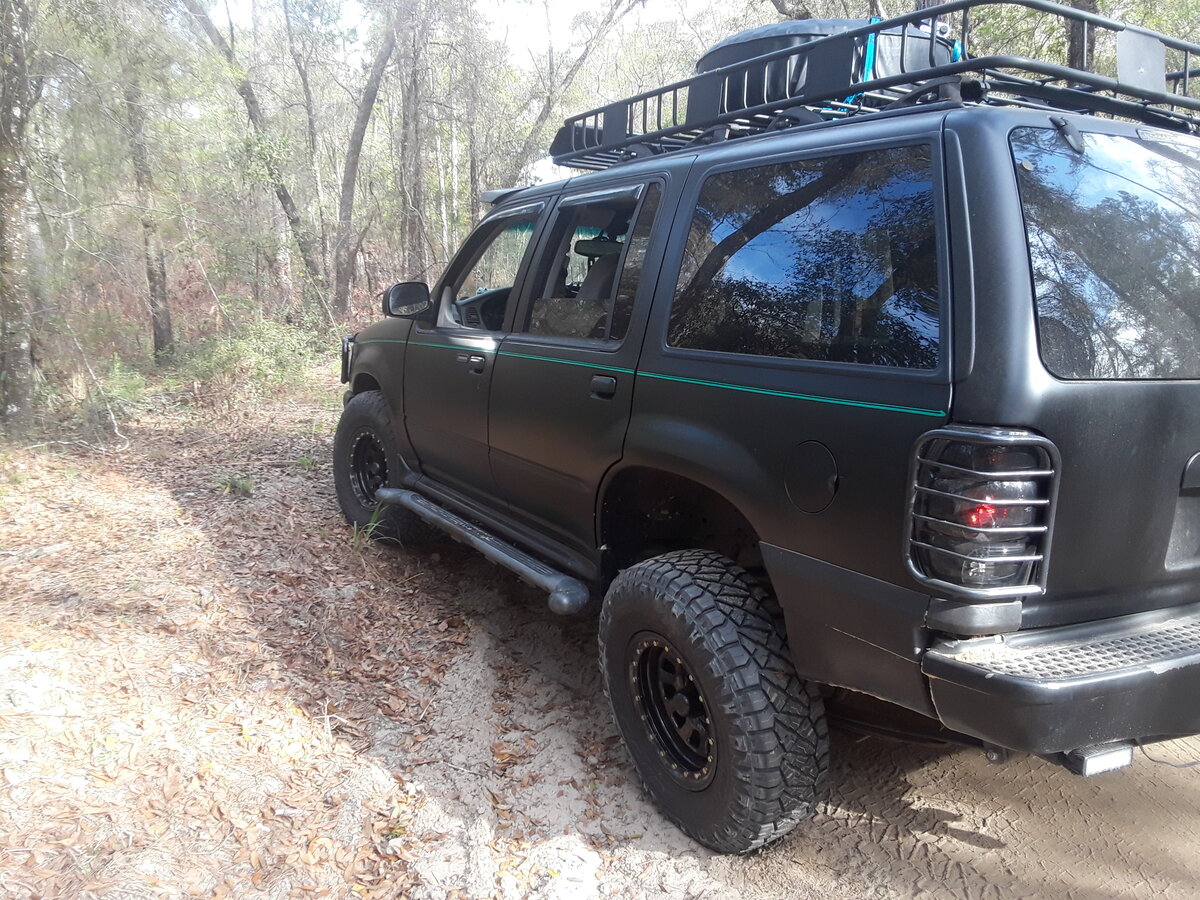

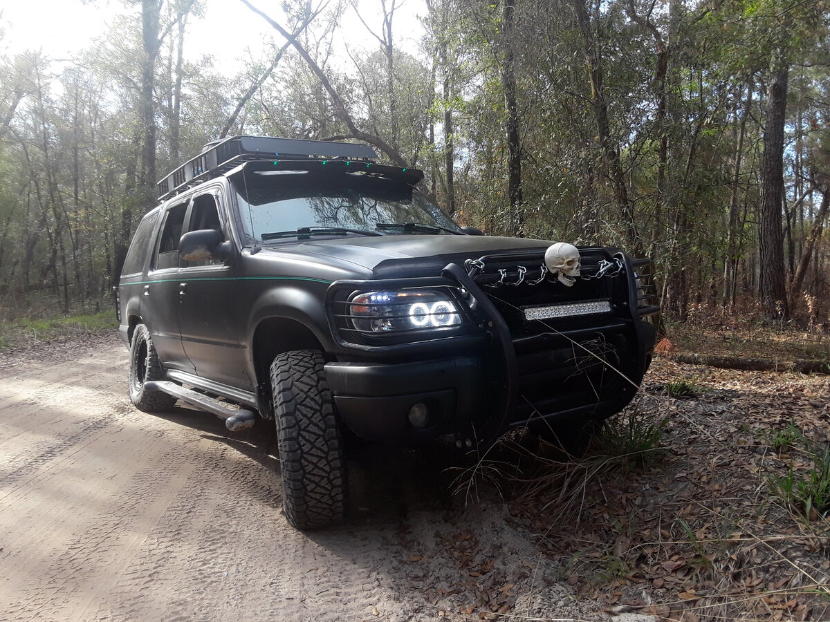

Yeah, 33s pretty much are a no go unless ya want some serious trimming. I maxed out the TT and ran lifted shackles with 265/75r16s (32s) and still had to trim a little plastic up front on both the rocker trim and the bumper. 33s you'll be trimming metal based on what I could tell and 99% of others. Yeah, the guard wont work along with the bodylift unless ya customize the brackets to work, I've seen it done and almost did it for mine since I planned to add a 1-2" bodylift just in case of fitment, but decided against it in the end. And just going to add a bunch from around mine as an idea
20220304_150158(0).jpg 20220308_085240.jpg 20220308_085207.jpg 20220308_085150.jpg 20220407_192855.jpg 20220407_192844.jpg 20220407_192828.jpg

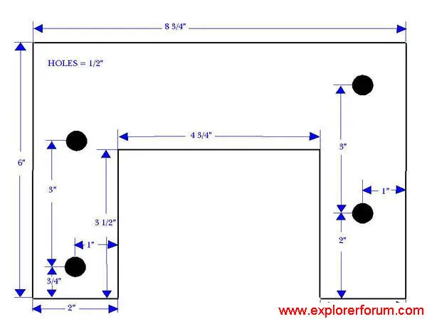

There was a cad file/ drawing of Gen II body lift bumper brackets on here years ago
I traded a 30 pack of beer to have my old brackets cut from metal

Found this​
Thats it!! Well done blast from the past
