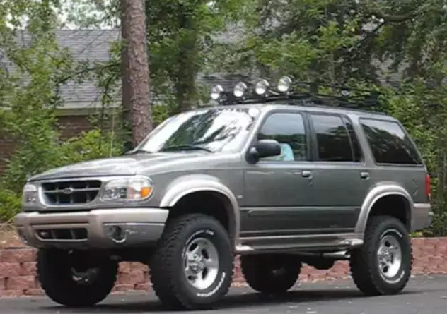

Thanks Elessar65. Ya it looks the truck in this picture has the same rims I do:
He's running 295/65/16 BFG All-Terrains, so I guess those are 33"s? Also, I think 295 is about as wide as the 16x7 rims will handle, right?
This truck has 3" spindles, and 3" TT.
Is 3" for the TT as far as you can go on a 2WD explorer? The truck in the photo is just about perfect, except I would go with another inch or two in the front
