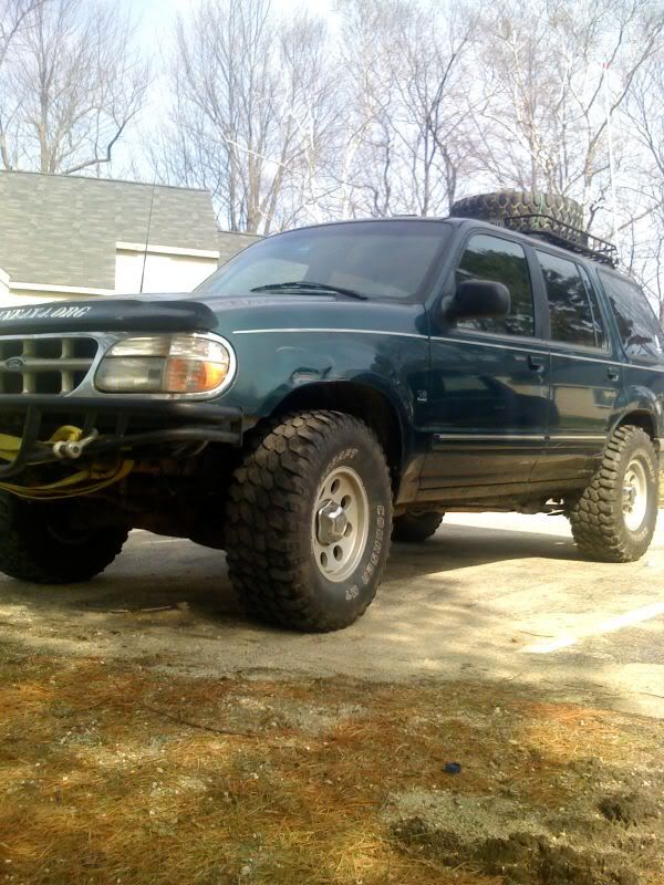

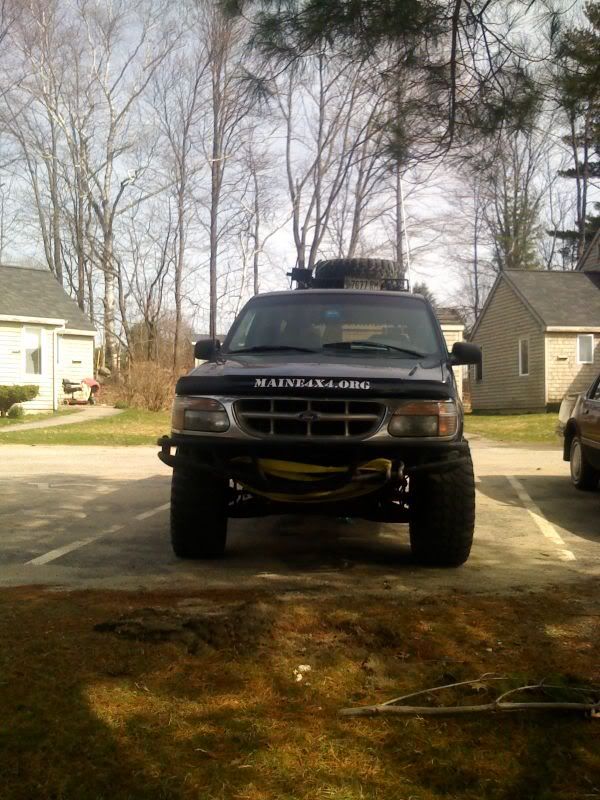

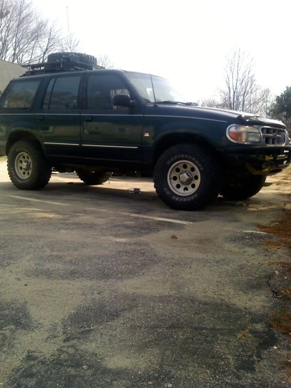

This is with a 2.5 TT, a 2" AAL thats sagged down to 1.5 ( and I was planing on that sag ) And a WAR153 shackle lift.
These are 33x12.5x15's on AR Rims. NO RUBBING AT ALL ANYWHERE and there was NO cutting or trimming.. Runs and goes great.
SO UPDATE 33's CAN AND WILL FIT with NO CUTTING with a tt. war153 and AAL.
I have had no problems wheeling it like this either And I go off road every other weekend. The only damage I did was break the transfer case. Thats not because of lift.
