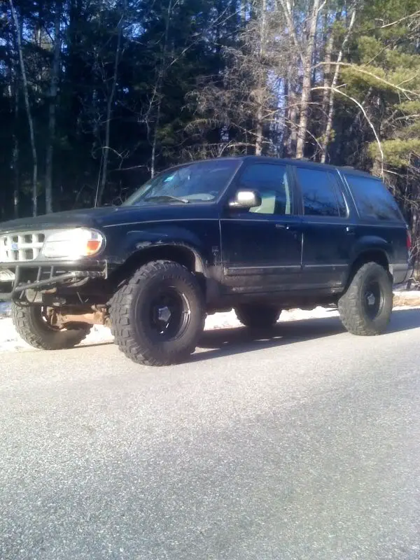

I have 2 inches of lift and am sitting on 33/12.50r15. I only rub at full lock to the left. it will rub when you have some suspension travel but other than that it is fine. I will be doing a body lift sometime though. here are some pictures.
just for reference here is my truck with 2 inches of lift with 31/10.50r15

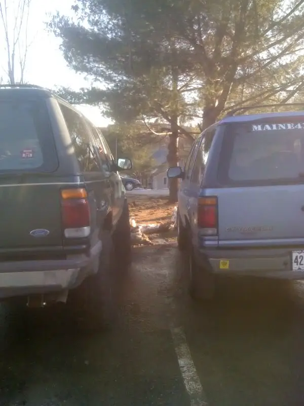

this is with 2.5" TT in front 3" AAL+War153 shackle in the rear. With a set of 32x10.5x15's. 33's would fit with VERY VERY minor trimming.

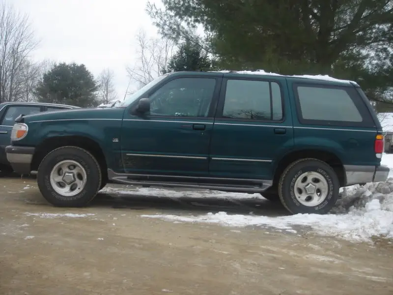

SO to recap this is stock
And after the 2.5-3
Next to my wifes stock AWD V8 Explorer.
Also I have wheeled this with my Sway Bars attached and have had NO binding.
