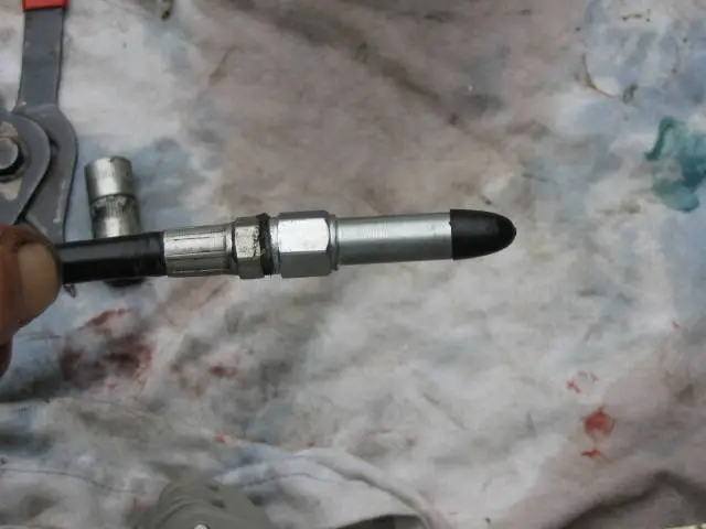

You can also get a grease injecting needle

I saw it t oreilly and asked. In the section where they sell grease guns there are a bunch of different fittings.
Seriously, I have learned everything here and by taking stuff apart.
There is also a nipple for squirting grease into the new cv -but I bet the needle would get it in there also.
This is my picture, I give myself permission to use it
There is a small hole on the end of the cv which meets the transfer case.Right where your fingers are in the video still picture. Fill it with grease.
